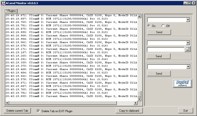

Ik heb sinds kort een "probleempje" dat het lijkt alsof ACamd constant met mijn Dreambox connect. Voorheen was dit niet het geval. Nu weet ik niet zeker of ik zelf iets heb veranderd of dat dit opeens is gebeurd.
Maar hoe kan ik het oplossen?
In ACamd.ini staat alleen dit:
[ACamd]
FilterSeca2=1
DisableEcmCache=1
Bestand met een printscreen is toegevoegd.

12:41:56.718: CCcamN 0: ECM [070B][0100/0000006A] Pro (0.016)
12:41:56.796: CCcamN 0: Current Share 00000064, CAID 0100, Hops 0, NodeID 01829824235AF86D
12:41:56.812: CCcamN 0: ECM [070B][0100/0000006A] Pro (0.016)
12:41:56.906: CCcamN 0: Current Share 00000064, CAID 0100, Hops 0, NodeID 01829824235AF86D
12:41:56.921: CCcamN 0: ECM [070B][0100/0000006A] Pro (0.015)
12:41:57.000: CCcamN 0: Current Share 00000064, CAID 0100, Hops 0, NodeID 01829824235AF86D
12:41:57.031: CCcamN 0: ECM [070B][0100/0000006A] Pro (0.032)
12:41:57.109: CCcamN 0: Current Share 00000064, CAID 0100, Hops 0, NodeID 01829824235AF86D
12:41:57.125: CCcamN 0: ECM [070B][0100/0000006A] Pro (0.015)
12:41:57.203: CCcamN 0: Current Share 00000064, CAID 0100, Hops 0, NodeID 01829824235AF86D
12:41:57.218: CCcamN 0: ECM [070B][0100/0000006A] Pro (0.016)
12:41:57.296: CCcamN 0: Current Share 00000064, CAID 0100, Hops 0, NodeID 01829824235AF86D
12:41:57.328: CCcamN 0: ECM [070B][0100/0000006A] Pro (0.031)
12:41:57.406: CCcamN 0: Current Share 00000064, CAID 0100, Hops 0, NodeID 01829824235AF86D
12:41:57.421: CCcamN 0: ECM [070B][0100/0000006A] Pro (0.015)
12:41:57.500: CCcamN 0: Current Share 00000064, CAID 0100, Hops 0, NodeID 01829824235AF86D
12:41:57.531: CCcamN 0: ECM [070B][0100/0000006A] Pro (0.032)
12:41:57.593: CCcamN 0: Current Share 00000064, CAID 0100, Hops 0, NodeID 01829824235AF86D
12:41:57.625: CCcamN 0: ECM [070B][0100/0000006A] Pro (0.031)
12:41:57.703: CCcamN 0: Current Share 00000064, CAID 0100, Hops 0, NodeID 01829824235AF86D
12:41:57.718: CCcamN 0: ECM [070B][0100/0000006A] Pro (0.016)
12:41:57.796: CCcamN 0: Current Share 00000064, CAID 0100, Hops 0, NodeID 01829824235AF86D
12:41:57.828: CCcamN 0: ECM [070B][0100/0000006A] Pro (0.031)
12:41:57.906: CCcamN 0: Current Share 00000064, CAID 0100, Hops 0, NodeID 01829824235AF86D
12:41:57.921: CCcamN 0: ECM [070B][0100/0000006A] Pro (0.015)
12:41:58.000: CCcamN 0: Current Share 00000064, CAID 0100, Hops 0, NodeID 01829824235AF86D
12:41:58.031: CCcamN 0: ECM [070B][0100/0000006A] Pro (0.032)
12:41:58.093: CCcamN 0: Current Share 00000064, CAID 0100, Hops 0, NodeID 01829824235AF86D
12:41:58.125: CCcamN 0: ECM [070B][0100/0000006A] Pro (0.031)
12:41:58.203: CCcamN 0: Current Share 00000064, CAID 0100, Hops 0, NodeID 01829824235AF86D
12:41:58.234: CCcamN 0: ECM [070B][0100/0000006A] Pro (0.032)
12:41:58.296: CCcamN 0: Current Share 00000064, CAID 0100, Hops 0, NodeID 01829824235AF86D
12:41:58.328: CCcamN 0: ECM [070B][0100/0000006A] Pro (0.031)
12:41:58.406: CCcamN 0: Current Share 00000064, CAID 0100, Hops 0, NodeID 01829824235AF86D
12:41:58.421: CCcamN 0: ECM [070B][0100/0000006A] Pro (0.015)
12:41:58.500: CCcamN 0: Current Share 00000064, CAID 0100, Hops 0, NodeID 01829824235AF86D
12:41:58.531: CCcamN 0: ECM [070B][0100/0000006A] Pro (0.032)
12:41:58.609: CCcamN 0: Current Share 00000064, CAID 0100, Hops 0, NodeID 01829824235AF86D
12:41:58.625: CCcamN 0: ECM [070B][0100/0000006A] Pro (0.015)
12:41:58.703: CCcamN 0: Current Share 00000064, CAID 0100, Hops 0, NodeID 01829824235AF86D
12:41:58.734: CCcamN 0: ECM [070B][0100/0000006A] Pro (0.032)
12:41:58.796: CCcamN 0: Current Share 00000064, CAID 0100, Hops 0, NodeID 01829824235AF86D
12:41:58.828: CCcamN 0: ECM [070B][0100/0000006A] Pro (0.031)
12:41:58.906: CCcamN 0: Current Share 00000064, CAID 0100, Hops 0, NodeID 01829824235AF86D
12:41:58.921: CCcamN 0: ECM [070B][0100/0000006A] Pro (0.015)
12:41:59.000: CCcamN 0: Current Share 00000064, CAID 0100, Hops 0, NodeID 01829824235AF86D
12:41:59.031: CCcamN 0: ECM [070B][0100/0000006A] Pro (0.032)
12:41:59.109: CCcamN 0: Current Share 00000064, CAID 0100, Hops 0, NodeID 01829824235AF86D
12:41:59.125: CCcamN 0: ECM [070B][0100/0000006A] Pro (0.015)
12:41:59.203: CCcamN 0: Current Share 00000064, CAID 0100, Hops 0, NodeID 01829824235AF86D
12:41:59.234: CCcamN 0: ECM [070B][0100/0000006A] Pro (0.032)
12:41:59.296: CCcamN 0: Current Share 00000064, CAID 0100, Hops 0, NodeID 01829824235AF86D
12:41:59.328: CCcamN 0: ECM [070B][0100/0000006A] Pro (0.031)
12:41:59.406: CCcamN 0: Current Share 00000064, CAID 0100, Hops 0, NodeID 01829824235AF86D
12:41:59.421: CCcamN 0: ECM [070B][0100/0000006A] Pro (0.015)
12:41:59.500: CCcamN 0: Current Share 00000064, CAID 0100, Hops 0, NodeID 01829824235AF86D
12:41:59.531: CCcamN 0: ECM [070B][0100/0000006A] Pro (0.032)
12:41:59.609: CCcamN 0: Current Share 00000064, CAID 0100, Hops 0, NodeID 01829824235AF86D
12:41:59.625: CCcamN 0: ECM [070B][0100/0000006A] Pro (0.015)
12:41:59.703: CCcamN 0: Current Share 00000064, CAID 0100, Hops 0, NodeID 01829824235AF86D
12:41:59.734: CCcamN 0: ECM [070B][0100/0000006A] Pro (0.032)
12:41:59.812: CCcamN 0: Current Share 00000064, CAID 0100, Hops 0, NodeID 01829824235AF86D
12:41:59.828: CCcamN 0: ECM [070B][0100/0000006A] Pro (0.015)
12:41:59.906: CCcamN 0: Current Share 00000064, CAID 0100, Hops 0, NodeID 01829824235AF86D
12:41:59.937: CCcamN 0: ECM [070B][0100/0000006A] Pro (0.031)
12:42:00.015: CCcamN 0: Current Share 00000064, CAID 0100, Hops 0, NodeID 01829824235AF86D
12:42:00.031: CCcamN 0: ECM [070B][0100/0000006A] Pro (0.016)
12:42:00.109: CCcamN 0: Current Share 00000064, CAID 0100, Hops 0, NodeID 01829824235AF86D
12:42:00.125: CCcamN 0: ECM [070B][0100/0000006A] Pro (0.015)
12:42:00.203: CCcamN 0: Current Share 00000064, CAID 0100, Hops 0, NodeID 01829824235AF86D
12:42:00.234: CCcamN 0: ECM [070B][0100/0000006A] Pro (0.032)
12:42:00.312: CCcamN 0: Current Share 00000064, CAID 0100, Hops 0, NodeID 01829824235AF86D
12:42:00.328: CCcamN 0: ECM [070B][0100/0000006A] Pro (0.015)
12:42:00.406: CCcamN 0: Current Share 00000064, CAID 0100, Hops 0, NodeID 01829824235AF86D
12:42:00.437: CCcamN 0: ECM [070B][0100/0000006A] Pro (0.031)
12:42:00.515: CCcamN 0: Current Share 00000064, CAID 0100, Hops 0, NodeID 01829824235AF86D
12:42:00.531: CCcamN 0: ECM [070B][0100/0000006A] Pro (0.016)
12:42:00.609: CCcamN 0: Current Share 00000064, CAID 0100, Hops 0, NodeID 01829824235AF86D
12:42:00.625: CCcamN 0: ECM [070B][0100/0000006A] Pro (0.015)
12:42:00.703: CCcamN 0: Current Share 00000064, CAID 0100, Hops 0, NodeID 01829824235AF86D
12:42:00.734: CCcamN 0: ECM [070B][0100/0000006A] Pro (0.032)
12:42:00.812: CCcamN 0: Current Share 00000064, CAID 0100, Hops 0, NodeID 01829824235AF86D
12:42:00.828: CCcamN 0: ECM [070B][0100/0000006A] Pro (0.015)
12:42:00.906: CCcamN 0: Current Share 00000064, CAID 0100, Hops 0, NodeID 01829824235AF86D
12:42:00.937: CCcamN 0: ECM [070B][0100/0000006A] Pro (0.031)
12:42:01.015: CCcamN 0: Current Share 00000064, CAID 0100, Hops 0, NodeID 01829824235AF86D
12:42:01.031: CCcamN 0: ECM [070B][0100/0000006A] Pro (0.016)
12:42:01.109: CCcamN 0: Current Share 00000064, CAID 0100, Hops 0, NodeID 01829824235AF86D
12:42:01.125: CCcamN 0: ECM [070B][0100/0000006A] Pro (0.015)
12:42:01.218: CCcamN 0: Current Share 00000064, CAID 0100, Hops 0, NodeID 01829824235AF86D
12:42:01.234: CCcamN 0: ECM [070B][0100/0000006A] Pro (0.016)
12:42:01.312: CCcamN 0: Current Share 00000064, CAID 0100, Hops 0, NodeID 01829824235AF86D
12:42:01.343: CCcamN 0: ECM [070B][0100/0000006A] Pro (0.031)
12:42:01.406: CCcamN 0: Current Share 00000064, CAID 0100, Hops 0, NodeID 01829824235AF86D
12:42:01.437: CCcamN 0: ECM [070B][0100/0000006A] Pro (0.031)
12:42:01.515: CCcamN 0: Current Share 00000064, CAID 0100, Hops 0, NodeID 01829824235AF86D
12:42:01.531: CCcamN 0: ECM [070B][0100/0000006A] Pro (0.016)
12:42:01.609: CCcamN 0: Current Share 00000064, CAID 0100, Hops 0, NodeID 01829824235AF86D
12:42:01.640: CCcamN 0: ECM [070B][0100/0000006A] Pro (0.031)
12:42:01.718: CCcamN 0: Current Share 00000064, CAID 0100, Hops 0, NodeID 01829824235AF86D
12:42:01.734: CCcamN 0: ECM [070B][0100/0000006A] Pro (0.016)
12:42:01.812: CCcamN 0: Current Share 00000064, CAID 0100, Hops 0, NodeID 01829824235AF86D
12:42:01.843: CCcamN 0: ECM [070B][0100/0000006A] Pro (0.031)
12:42:01.906: CCcamN 0: Current Share 00000064, CAID 0100, Hops 0, NodeID 01829824235AF86D
12:42:01.937: CCcamN 0: ECM [070B][0100/0000006A] Pro (0.031)
12:42:02.015: CCcamN 0: Current Share 00000064, CAID 0100, Hops 0, NodeID 01829824235AF86D
12:42:02.031: CCcamN 0: ECM [070B][0100/0000006A] Pro (0.016)
12:42:02.109: CCcamN 0: Current Share 00000064, CAID 0100, Hops 0, NodeID 01829824235AF86D
12:42:02.140: CCcamN 0: ECM [070B][0100/0000006A] Pro (0.031)
12:42:02.218: CCcamN 0: Current Share 00000064, CAID 0100, Hops 0, NodeID 01829824235AF86D
12:42:02.234: CCcamN 0: ECM [070B][0100/0000006A] Pro (0.016)
12:42:02.312: CCcamN 0: Current Share 00000064, CAID 0100, Hops 0, NodeID 01829824235AF86D
12:42:02.343: CCcamN 0: ECM [070B][0100/0000006A] Pro (0.031)
12:42:02.406: CCcamN 0: Current Share 00000064, CAID 0100, Hops 0, NodeID 01829824235AF86D
12:42:02.437: CCcamN 0: ECM [070B][0100/0000006A] Pro (0.031)
12:42:02.515: CCcamN 0: Current Share 00000064, CAID 0100, Hops 0, NodeID 01829824235AF86D
12:42:02.546: CCcamN 0: ECM [070B][0100/0000006A] Pro (0.031)
12:42:02.609: CCcamN 0: Current Share 00000064, CAID 0100, Hops 0, NodeID 01829824235AF86D
12:42:02.640: CCcamN 0: ECM [070B][0100/0000006A] Pro (0.031)
12:42:02.718: CCcamN 0: Current Share 00000064, CAID 0100, Hops 0, NodeID 01829824235AF86D
12:42:02.734: CCcamN 0: ECM [070B][0100/0000006A] Pro (0.016)
12:42:02.812: CCcamN 0: Current Share 00000064, CAID 0100, Hops 0, NodeID 01829824235AF86D
12:42:02.843: CCcamN 0: ECM [070B][0100/0000006A] Pro (0.031)
12:42:02.921: CCcamN 0: Current Share 00000064, CAID 0100, Hops 0, NodeID 01829824235AF86D
12:42:02.937: CCcamN 0: ECM [070B][0100/0000006A] Pro (0.016)
12:42:03.015: CCcamN 0: Current Share 00000064, CAID 0100, Hops 0, NodeID 01829824235AF86D
12:42:03.046: CCcamN 0: ECM [070B][0100/0000006A] Pro (0.031)
12:42:03.109: CCcamN 0: Current Share 00000064, CAID 0100, Hops 0, NodeID 01829824235AF86D
12:42:03.140: CCcamN 0: ECM [070B][0100/0000006A] Pro (0.031)
12:42:03.218: CCcamN 0: Current Share 00000064, CAID 0100, Hops 0, NodeID 01829824235AF86D
12:42:03.234: CCcamN 0: ECM [070B][0100/0000006A] Pro (0.016)
12:42:03.312: CCcamN 0: Current Share 00000064, CAID 0100, Hops 0, NodeID 01829824235AF86D
12:42:03.343: CCcamN 0: ECM [070B][0100/0000006A] Pro (0.031)
12:42:03.421: CCcamN 0: Current Share 00000064, CAID 0100, Hops 0, NodeID 01829824235AF86D
12:42:03.437: CCcamN 0: ECM [070B][0100/0000006A] Pro (0.016)
12:42:03.515: CCcamN 0: Current Share 00000064, CAID 0100, Hops 0, NodeID 01829824235AF86D
12:42:03.546: CCcamN 0: ECM [070B][0100/0000006A] Pro (0.031)
12:42:03.609: CCcamN 0: Current Share 00000064, CAID 0100, Hops 0, NodeID 01829824235AF86D
12:42:03.640: CCcamN 0: ECM [070B][0100/0000006A] Pro (0.031)
12:42:03.718: CCcamN 0: Current Share 00000064, CAID 0100, Hops 0, NodeID 01829824235AF86D
12:42:03.734: CCcamN 0: ECM [070B][0100/0000006A] Pro (0.016)
12:42:03.812: CCcamN 0: Current Share 00000064, CAID 0100, Hops 0, NodeID 01829824235AF86D
12:42:03.843: CCcamN 0: ECM [070B][0100/0000006A] Pro (0.031)
12:42:03.921: CCcamN 0: Current Share 00000064, CAID 0100, Hops 0, NodeID 01829824235AF86D
12:42:03.937: CCcamN 0: ECM [070B][0100/0000006A] Pro (0.016)
12:42:04.000: CCcamN 0: Current Share 00000064, CAID 0100, Hops 0, NodeID 01829824235AF86D
12:42:04.343: CCcamN 0: ECM [070B][0100/0000006A] Pro (0.344)
12:42:04.343: CCcamN 0: Current Share 00000064, CAID 0100, Hops 0, NodeID 01829824235AF86D
12:42:04.359: [00] SendDCW Even: 76AC7496FFFB827C:
12:42:04.359: CCcamN 0: ECM [070B][0100/0000006A] Pro (0.016)
12:42:04.359: CCcamN 0: Current Share 00000064, CAID 0100, Hops 0, NodeID 01829824235AF86D
12:42:04.375: CCcamN 0: ECM [070B][0100/0000006A] Pro (0.015)
12:42:04.375: CCcamN 0: Current Share 00000064, CAID 0100, Hops 0, NodeID 01829824235AF86D
12:42:04.390: CCcamN 0: ECM [070B][0100/0000006A] Pro (0.016)
12:42:04.390: CCcamN 0: Current Share 00000064, CAID 0100, Hops 0, NodeID 01829824235AF86D
12:42:04.421: CCcamN 0: ECM [070B][0100/0000006A] Pro (0.031)
12:42:04.500: CCcamN 0: Current Share 00000064, CAID 0100, Hops 0, NodeID 01829824235AF86D
12:42:04.515: CCcamN 0: ECM [070B][0100/0000006A] Pro (0.016)
12:42:04.593: CCcamN 0: Current Share 00000064, CAID 0100, Hops 0, NodeID 01829824235AF86D
12:42:04.625: CCcamN 0: ECM [070B][0100/0000006A] Pro (0.031)
12:42:04.703: CCcamN 0: Current Share 00000064, CAID 0100, Hops 0, NodeID 01829824235AF86D
12:42:04.718: CCcamN 0: ECM [070B][0100/0000006A] Pro (0.016)
12:42:04.796: CCcamN 0: Current Share 00000064, CAID 0100, Hops 0, NodeID 01829824235AF86D
12:42:04.812: CCcamN 0: ECM [070B][0100/0000006A] Pro (0.016)
12:42:04.890: CCcamN 0: Current Share 00000064, CAID 0100, Hops 0, NodeID 01829824235AF86D
12:42:04.921: CCcamN 0: ECM [070B][0100/0000006A] Pro (0.031)
12:42:05.000: CCcamN 0: Current Share 00000064, CAID 0100, Hops 0, NodeID 01829824235AF86D
12:42:05.015: CCcamN 0: ECM [070B][0100/0000006A] Pro (0.016)
12:42:05.093: CCcamN 0: Current Share 00000064, CAID 0100, Hops 0, NodeID 01829824235AF86D
12:42:05.125: CCcamN 0: ECM [070B][0100/0000006A] Pro (0.031)
12:42:05.203: CCcamN 0: Current Share 00000064, CAID 0100, Hops 0, NodeID 01829824235AF86D
12:42:05.218: CCcamN 0: ECM [070B][0100/0000006A] Pro (0.016)
12:42:05.296: CCcamN 0: Current Share 00000064, CAID 0100, Hops 0, NodeID 01829824235AF86D
12:42:05.312: CCcamN 0: ECM [070B][0100/0000006A] Pro (0.016)
12:42:05.406: CCcamN 0: Current Share 00000064, CAID 0100, Hops 0, NodeID 01829824235AF86D
12:42:05.421: CCcamN 0: ECM [070B][0100/0000006A] Pro (0.015)
12:42:05.500: CCcamN 0: Current Share 00000064, CAID 0100, Hops 0, NodeID 01829824235AF86D
12:42:05.515: CCcamN 0: ECM [070B][0100/0000006A] Pro (0.016)
12:42:05.593: CCcamN 0: Current Share 00000064, CAID 0100, Hops 0, NodeID 01829824235AF86D
12:42:05.625: CCcamN 0: ECM [070B][0100/0000006A] Pro (0.031)
12:42:05.703: CCcamN 0: Current Share 00000064, CAID 0100, Hops 0, NodeID 01829824235AF86D
12:42:05.718: CCcamN 0: ECM [070B][0100/0000006A] Pro (0.016)
12:42:05.796: CCcamN 0: Current Share 00000064, CAID 0100, Hops 0, NodeID 01829824235AF86D
12:42:05.828: CCcamN 0: ECM [070B][0100/0000006A] Pro (0.031)
12:42:05.906: CCcamN 0: Current Share 00000064, CAID 0100, Hops 0, NodeID 01829824235AF86D
12:42:05.921: CCcamN 0: ECM [070B][0100/0000006A] Pro (0.015)
12:42:06.000: CCcamN 0: Current Share 00000064, CAID 0100, Hops 0, NodeID 01829824235AF86D
12:42:06.015: CCcamN 0: ECM [070B][0100/0000006A] Pro (0.016)
12:42:06.093: CCcamN 0: Current Share 00000064, CAID 0100, Hops 0, NodeID 01829824235AF86D
12:42:06.125: CCcamN 0: ECM [070B][0100/0000006A] Pro (0.031)
12:42:06.203: CCcamN 0: Current Share 00000064, CAID 0100, Hops 0, NodeID 01829824235AF86D
12:42:06.218: CCcamN 0: ECM [070B][0100/0000006A] Pro (0.016)
12:42:06.296: CCcamN 0: Current Share 00000064, CAID 0100, Hops 0, NodeID 01829824235AF86D
12:42:06.328: CCcamN 0: ECM [070B][0100/0000006A] Pro (0.031)
12:42:06.390: CCcamN 0: Current Share 00000064, CAID 0100, Hops 0, NodeID 01829824235AF86D
12:42:06.421: CCcamN 0: ECM [070B][0100/0000006A] Pro (0.031)
12:42:06.500: CCcamN 0: Current Share 00000064, CAID 0100, Hops 0, NodeID 01829824235AF86D
12:42:06.515: CCcamN 0: ECM [070B][0100/0000006A] Pro (0.016)
12:42:06.593: CCcamN 0: Current Share 00000064, CAID 0100, Hops 0, NodeID 01829824235AF86D
12:42:06.625: CCcamN 0: ECM [070B][0100/0000006A] Pro (0.031)
12:42:06.703: CCcamN 0: Current Share 00000064, CAID 0100, Hops 0, NodeID 01829824235AF86D
12:42:06.718: CCcamN 0: ECM [070B][0100/0000006A] Pro (0.016)
12:42:06.796: CCcamN 0: Current Share 00000064, CAID 0100, Hops 0, NodeID 01829824235AF86D
12:42:06.828: CCcamN 0: ECM [070B][0100/0000006A] Pro (0.031)
12:42:06.906: CCcamN 0: Current Share 00000064, CAID 0100, Hops 0, NodeID 01829824235AF86D
12:42:06.937: CCcamN 0: ECM [070B][0100/0000006A] Pro (0.031)
12:42:07.000: CCcamN 0: Current Share 00000064, CAID 0100, Hops 0, NodeID 01829824235AF86D
12:42:07.031: CCcamN 0: ECM [070B][0100/0000006A] Pro (0.032)
12:42:07.109: CCcamN 0: Current Share 00000064, CAID 0100, Hops 0, NodeID 01829824235AF86D
12:42:07.125: CCcamN 0: ECM [070B][0100/0000006A] Pro (0.015)
12:42:07.203: CCcamN 0: Current Share 00000064, CAID 0100, Hops 0, NodeID 01829824235AF86D
12:42:07.218: CCcamN 0: ECM [070B][0100/0000006A] Pro (0.016)
12:42:07.296: CCcamN 0: Current Share 00000064, CAID 0100, Hops 0, NodeID 01829824235AF86D
12:42:07.328: CCcamN 0: ECM [070B][0100/0000006A] Pro (0.031)
12:42:07.406: CCcamN 0: Current Share 00000064, CAID 0100, Hops 0, NodeID 01829824235AF86D
12:42:07.421: CCcamN 0: ECM [070B][0100/0000006A] Pro (0.015)
12:42:07.500: CCcamN 0: Current Share 00000064, CAID 0100, Hops 0, NodeID 01829824235AF86D
12:42:07.531: CCcamN 0: ECM [070B][0100/0000006A] Pro (0.032)
12:42:07.609: CCcamN 0: Current Share 00000064, CAID 0100, Hops 0, NodeID 01829824235AF86D
12:42:07.625: CCcamN 0: ECM [070B][0100/0000006A] Pro (0.015)
12:42:07.703: CCcamN 0: Current Share 00000064, CAID 0100, Hops 0, NodeID 01829824235AF86D
12:42:07.718: CCcamN 0: ECM [070B][0100/0000006A] Pro (0.016)
12:42:07.796: CCcamN 0: Current Share 00000064, CAID 0100, Hops 0, NodeID 01829824235AF86D
12:42:07.828: CCcamN 0: ECM [070B][0100/0000006A] Pro (0.031)
12:42:07.906: CCcamN 0: Current Share 00000064, CAID 0100, Hops 0, NodeID 01829824235AF86D
12:42:07.921: CCcamN 0: ECM [070B][0100/0000006A] Pro (0.015)
12:42:08.000: CCcamN 0: Current Share 00000064, CAID 0100, Hops 0, NodeID 01829824235AF86D
12:42:08.031: CCcamN 0: ECM [070B][0100/0000006A] Pro (0.032)
12:42:08.109: CCcamN 0: Current Share 00000064, CAID 0100, Hops 0, NodeID 01829824235AF86D
12:42:08.125: CCcamN 0: ECM [070B][0100/0000006A] Pro (0.015)
12:42:08.203: CCcamN 0: Current Share 00000064, CAID 0100, Hops 0, NodeID 01829824235AF86D
12:42:08.218: CCcamN 0: ECM [070B][0100/0000006A] Pro (0.016)
12:42:08.296: CCcamN 0: Current Share 00000064, CAID 0100, Hops 0, NodeID 01829824235AF86D
12:42:08.328: CCcamN 0: ECM [070B][0100/0000006A] Pro (0.031)
12:42:08.406: CCcamN 0: Current Share 00000064, CAID 0100, Hops 0, NodeID 01829824235AF86D
12:42:08.437: CCcamN 0: ECM [070B][0100/0000006A] Pro (0.031)
12:42:08.500: CCcamN 0: Current Share 00000064, CAID 0100, Hops 0, NodeID 01829824235AF86D
12:42:08.531: CCcamN 0: ECM [070B][0100/0000006A] Pro (0.032)
12:42:08.609: CCcamN 0: Current Share 00000064, CAID 0100, Hops 0, NodeID 01829824235AF86D
12:42:08.625: CCcamN 0: ECM [070B][0100/0000006A] Pro (0.015)
12:42:08.703: CCcamN 0: Current Share 00000064, CAID 0100, Hops 0, NodeID 01829824235AF86D
12:42:08.734: CCcamN 0: ECM [070B][0100/0000006A] Pro (0.032)
12:42:08.812: CCcamN 0: Current Share 00000064, CAID 0100, Hops 0, NodeID 01829824235AF86D
12:42:08.828: CCcamN 0: ECM [070B][0100/0000006A] Pro (0.015)
12:42:08.906: CCcamN 0: Current Share 00000064, CAID 0100, Hops 0, NodeID 01829824235AF86D
12:42:08.937: CCcamN 0: ECM [070B][0100/0000006A] Pro (0.031)
12:42:09.000: CCcamN 0: Current Share 00000064, CAID 0100, Hops 0, NodeID 01829824235AF86D
12:42:09.031: CCcamN 0: ECM [070B][0100/0000006A] Pro (0.032)
12:42:09.109: CCcamN 0: Current Share 00000064, CAID 0100, Hops 0, NodeID 01829824235AF86D
12:42:09.125: CCcamN 0: ECM [070B][0100/0000006A] Pro (0.015)
12:42:09.203: CCcamN 0: Current Share 00000064, CAID 0100, Hops 0, NodeID 01829824235AF86D
12:42:09.234: CCcamN 0: ECM [070B][0100/0000006A] Pro (0.032)
12:42:09.312: CCcamN 0: Current Share 00000064, CAID 0100, Hops 0, NodeID 01829824235AF86D
12:42:09.328: CCcamN 0: ECM [070B][0100/0000006A] Pro (0.015)
12:42:09.406: CCcamN 0: Current Share 00000064, CAID 0100, Hops 0, NodeID 01829824235AF86D
12:42:09.437: CCcamN 0: ECM [070B][0100/0000006A] Pro (0.031)
12:42:09.500: CCcamN 0: Current Share 00000064, CAID 0100, Hops 0, NodeID 01829824235AF86D
12:42:09.531: CCcamN 0: ECM [070B][0100/0000006A] Pro (0.032)
12:42:09.609: CCcamN 0: Current Share 00000064, CAID 0100, Hops 0, NodeID 01829824235AF86D
12:42:09.625: CCcamN 0: ECM [070B][0100/0000006A] Pro (0.015)
12:42:09.718: CCcamN 0: Current Share 00000064, CAID 0100, Hops 0, NodeID 01829824235AF86D
12:42:09.734: CCcamN 0: ECM [070B][0100/0000006A] Pro (0.016)
12:42:09.812: CCcamN 0: Current Share 00000064, CAID 0100, Hops 0, NodeID 01829824235AF86D
12:42:09.828: CCcamN 0: ECM [070B][0100/0000006A] Pro (0.015)
12:42:09.906: CCcamN 0: Current Share 00000064, CAID 0100, Hops 0, NodeID 01829824235AF86D
12:42:09.937: CCcamN 0: ECM [070B][0100/0000006A] Pro (0.031)
12:42:10.015: CCcamN 0: Current Share 00000064, CAID 0100, Hops 0, NodeID 01829824235AF86D
12:42:10.031: CCcamN 0: ECM [070B][0100/0000006A] Pro (0.016)
12:42:10.109: CCcamN 0: Current Share 00000064, CAID 0100, Hops 0, NodeID 01829824235AF86D
12:42:10.140: CCcamN 0: ECM [070B][0100/0000006A] Pro (0.031)
12:42:10.203: CCcamN 0: Current Share 00000064, CAID 0100, Hops 0, NodeID 01829824235AF86D
12:42:10.234: CCcamN 0: ECM [070B][0100/0000006A] Pro (0.032)
12:42:10.312: CCcamN 0: Current Share 00000064, CAID 0100, Hops 0, NodeID 01829824235AF86D
12:42:10.328: CCcamN 0: ECM [070B][0100/0000006A] Pro (0.015)
12:42:10.406: CCcamN 0: Current Share 00000064, CAID 0100, Hops 0, NodeID 01829824235AF86D
12:42:10.437: CCcamN 0: ECM [070B][0100/0000006A] Pro (0.031)
12:42:10.515: CCcamN 0: Current Share 00000064, CAID 0100, Hops 0, NodeID 01829824235AF86D
12:42:10.531: CCcamN 0: ECM [070B][0100/0000006A] Pro (0.016)
12:42:10.609: CCcamN 0: Current Share 00000064, CAID 0100, Hops 0, NodeID 01829824235AF86D
12:42:10.640: CCcamN 0: ECM [070B][0100/0000006A] Pro (0.031)
12:42:10.703: CCcamN 0: Current Share 00000064, CAID 0100, Hops 0, NodeID 01829824235AF86D
12:42:10.734: CCcamN 0: ECM [070B][0100/0000006A] Pro (0.032)
12:42:10.812: CCcamN 0: Current Share 00000064, CAID 0100, Hops 0, NodeID 01829824235AF86D
12:42:10.828: CCcamN 0: ECM [070B][0100/0000006A] Pro (0.015)
12:42:10.906: CCcamN 0: Current Share 00000064, CAID 0100, Hops 0, NodeID 01829824235AF86D
12:42:10.937: CCcamN 0: ECM [070B][0100/0000006A] Pro (0.031)
12:42:11.015: CCcamN 0: Current Share 00000064, CAID 0100, Hops 0, NodeID 01829824235AF86D
12:42:11.031: CCcamN 0: ECM [070B][0100/0000006A] Pro (0.016)
12:42:11.109: CCcamN 0: Current Share 00000064, CAID 0100, Hops 0, NodeID 01829824235AF86D
12:42:11.140: CCcamN 0: ECM [070B][0100/0000006A] Pro (0.031)
12:42:11.203: CCcamN 0: Current Share 00000064, CAID 0100, Hops 0, NodeID 01829824235AF86D
12:42:11.234: CCcamN 0: ECM [070B][0100/0000006A] Pro (0.032)
12:42:11.312: CCcamN 0: Current Share 00000064, CAID 0100, Hops 0, NodeID 01829824235AF86D
12:42:11.328: CCcamN 0: ECM [070B][0100/0000006A] Pro (0.015)
12:42:11.421: CCcamN 0: Current Share 00000064, CAID 0100, Hops 0, NodeID 01829824235AF86D
12:42:11.437: CCcamN 0: ECM [070B][0100/0000006A] Pro (0.016)
12:42:11.515: CCcamN 0: Current Share 00000064, CAID 0100, Hops 0, NodeID 01829824235AF86D
12:42:11.531: CCcamN 0: ECM [070B][0100/0000006A] Pro (0.016)
12:42:11.609: CCcamN 0: Current Share 00000064, CAID 0100, Hops 0, NodeID 01829824235AF86D
12:42:11.640: CCcamN 0: ECM [070B][0100/0000006A] Pro (0.031)
12:42:11.718: CCcamN 0: Current Share 00000064, CAID 0100, Hops 0, NodeID 01829824235AF86D
12:42:11.734: CCcamN 0: ECM [070B][0100/0000006A] Pro (0.016)
12:42:11.812: CCcamN 0: Current Share 00000064, CAID 0100, Hops 0, NodeID 01829824235AF86D
12:42:11.843: CCcamN 0: ECM [070B][0100/0000006A] Pro (0.031)
12:42:11.921: CCcamN 0: Current Share 00000064, CAID 0100, Hops 0, NodeID 01829824235AF86D
12:42:11.953: CCcamN 0: ECM [070B][0100/0000006A] Pro (0.031)
12:42:12.015: CCcamN 0: Current Share 00000064, CAID 0100, Hops 0, NodeID 01829824235AF86D
12:42:12.031: CCcamN 0: ECM [070B][0100/0000006A] Pro (0.016)
12:42:12.109: CCcamN 0: Current Share 00000064, CAID 0100, Hops 0, NodeID 01829824235AF86D
12:42:12.140: CCcamN 0: ECM [070B][0100/0000006A] Pro (0.031)
12:42:12.218: CCcamN 0: Current Share 00000064, CAID 0100, Hops 0, NodeID 01829824235AF86D
12:42:12.234: CCcamN 0: ECM [070B][0100/0000006A] Pro (0.016)
12:42:12.312: CCcamN 0: Current Share 00000064, CAID 0100, Hops 0, NodeID 01829824235AF86D
12:42:12.343: CCcamN 0: ECM [070B][0100/0000006A] Pro (0.031)
12:42:12.406: CCcamN 0: Current Share 00000064, CAID 0100, Hops 0, NodeID 01829824235AF86D
12:42:12.437: CCcamN 0: ECM [070B][0100/0000006A] Pro (0.031)
12:42:12.515: CCcamN 0: Current Share 00000064, CAID 0100, Hops 0, NodeID 01829824235AF86D
12:42:12.546: CCcamN 0: ECM [070B][0100/0000006A] Pro (0.031)
12:42:12.609: CCcamN 0: Current Share 00000064, CAID 0100, Hops 0, NodeID 01829824235AF86D
12:42:12.640: CCcamN 0: ECM [070B][0100/0000006A] Pro (0.031)
12:42:12.718: CCcamN 0: Current Share 00000064, CAID 0100, Hops 0, NodeID 01829824235AF86D
12:42:12.734: CCcamN 0: ECM [070B][0100/0000006A] Pro (0.016)
12:42:12.812: CCcamN 0: Current Share 00000064, CAID 0100, Hops 0, NodeID 01829824235AF86D
12:42:12.843: CCcamN 0: ECM [070B][0100/0000006A] Pro (0.031)
12:42:12.921: CCcamN 0: Current Share 00000064, CAID 0100, Hops 0, NodeID 01829824235AF86D
12:42:12.937: CCcamN 0: ECM [070B][0100/0000006A] Pro (0.016)
12:42:13.015: CCcamN 0: Current Share 00000064, CAID 0100, Hops 0, NodeID 01829824235AF86D
12:42:13.046: CCcamN 0: ECM [070B][0100/0000006A] Pro (0.031)
12:42:13.125: CCcamN 0: Current Share 00000064, CAID 0100, Hops 0, NodeID 01829824235AF86D
12:42:13.140: CCcamN 0: ECM [070B][0100/0000006A] Pro (0.016)
12:42:13.218: CCcamN 0: Current Share 00000064, CAID 0100, Hops 0, NodeID 01829824235AF86D
12:42:13.250: CCcamN 0: ECM [070B][0100/0000006A] Pro (0.031)
12:42:13.312: CCcamN 0: Current Share 00000064, CAID 0100, Hops 0, NodeID 01829824235AF86D
12:42:13.343: CCcamN 0: ECM [070B][0100/0000006A] Pro (0.031)
12:42:13.421: CCcamN 0: Current Share 00000064, CAID 0100, Hops 0, NodeID 01829824235AF86D
12:42:13.453: CCcamN 0: ECM [070B][0100/0000006A] Pro (0.031)
12:42:13.515: CCcamN 0: Current Share 00000064, CAID 0100, Hops 0, NodeID 01829824235AF86D
12:42:13.546: CCcamN 0: ECM [070B][0100/0000006A] Pro (0.031)
12:42:13.625: CCcamN 0: Current Share 00000064, CAID 0100, Hops 0, NodeID 01829824235AF86D
12:42:13.640: CCcamN 0: ECM [070B][0100/0000006A] Pro (0.016)
12:42:13.718: CCcamN 0: Current Share 00000064, CAID 0100, Hops 0, NodeID 01829824235AF86D
12:42:13.734: CCcamN 0: ECM [070B][0100/0000006A] Pro (0.016)
12:42:13.812: CCcamN 0: Current Share 00000064, CAID 0100, Hops 0, NodeID 01829824235AF86D
12:42:13.843: CCcamN 0: ECM [070B][0100/0000006A] Pro (0.031)
12:42:13.921: CCcamN 0: Current Share 00000064, CAID 0100, Hops 0, NodeID 01829824235AF86D
12:42:13.937: CCcamN 0: ECM [070B][0100/0000006A] Pro (0.016)
12:42:14.000: CCcamN 0: Current Share 00000064, CAID 0100, Hops 0, NodeID 01829824235AF86D
12:42:14.328: CCcamN 0: ECM [070B][0100/0000006A] Pro (0.328)
12:42:14.328: CCcamN 0: Current Share 00000064, CAID 0100, Hops 0, NodeID 01829824235AF86D
12:42:14.343: CCcamN 0: ECM [070B][0100/0000006A] Pro (0.016)
12:42:14.343: [00] SendDCW Odd: :9580C3D867045CC7
12:42:14.343: CCcamN 0: Current Share 00000064, CAID 0100, Hops 0, NodeID 01829824235AF86D
12:42:14.359: CCcamN 0: ECM [070B][0100/0000006A] Pro (0.016)
12:42:14.359: CCcamN 0: Current Share 00000064, CAID 0100, Hops 0, NodeID 01829824235AF86D
12:42:14.375: CCcamN 0: ECM [070B][0100/0000006A] Pro (0.015)
12:42:14.390: CCcamN 0: Current Share 00000064, CAID 0100, Hops 0, NodeID 01829824235AF86D
12:42:14.421: CCcamN 0: ECM [070B][0100/0000006A] Pro (0.031)
12:42:14.500: CCcamN 0: Current Share 00000064, CAID 0100, Hops 0, NodeID 01829824235AF86D
12:42:14.515: CCcamN 0: ECM [070B][0100/0000006A] Pro (0.016)
12:42:14.593: CCcamN 0: Current Share 00000064, CAID 0100, Hops 0, NodeID 01829824235AF86D
12:42:14.625: CCcamN 0: ECM [070B][0100/0000006A] Pro (0.031)
12:42:14.703: CCcamN 0: Current Share 00000064, CAID 0100, Hops 0, NodeID 01829824235AF86D
12:42:14.718: CCcamN 0: ECM [070B][0100/0000006A] Pro (0.016)
12:42:14.796: CCcamN 0: Current Share 00000064, CAID 0100, Hops 0, NodeID 01829824235AF86D
12:42:14.812: CCcamN 0: ECM [070B][0100/0000006A] Pro (0.016)
12:42:14.890: CCcamN 0: Current Share 00000064, CAID 0100, Hops 0, NodeID 01829824235AF86D
12:42:14.921: CCcamN 0: ECM [070B][0100/0000006A] Pro (0.031)
12:42:15.000: CCcamN 0: Current Share 00000064, CAID 0100, Hops 0, NodeID 01829824235AF86D
12:42:15.015: CCcamN 0: ECM [070B][0100/0000006A] Pro (0.016)
12:42:15.093: CCcamN 0: Current Share 00000064, CAID 0100, Hops 0, NodeID 01829824235AF86D
12:42:15.125: CCcamN 0: ECM [070B][0100/0000006A] Pro (0.031)
12:42:15.203: CCcamN 0: Current Share 00000064, CAID 0100, Hops 0, NodeID 01829824235AF86D
12:42:15.218: CCcamN 0: ECM [070B][0100/0000006A] Pro (0.016)
12:42:15.296: CCcamN 0: Current Share 00000064, CAID 0100, Hops 0, NodeID 01829824235AF86D
12:42:15.328: CCcamN 0: ECM [070B][0100/0000006A] Pro (0.031)
12:42:15.390: CCcamN 0: Current Share 00000064, CAID 0100, Hops 0, NodeID 01829824235AF86D
12:42:15.421: CCcamN 0: ECM [070B][0100/0000006A] Pro (0.031)
12:42:15.500: CCcamN 0: Current Share 00000064, CAID 0100, Hops 0, NodeID 01829824235AF86D
12:42:15.531: CCcamN 0: ECM [070B][0100/0000006A] Pro (0.032)
12:42:15.593: CCcamN 0: Current Share 00000064, CAID 0100, Hops 0, NodeID 01829824235AF86D
12:42:15.625: CCcamN 0: ECM [070B][0100/0000006A] Pro (0.031)
12:42:15.703: CCcamN 0: Current Share 00000064, CAID 0100, Hops 0, NodeID 01829824235AF86D
12:42:15.734: CCcamN 0: ECM [070B][0100/0000006A] Pro (0.032)
12:42:15.796: CCcamN 0: Current Share 00000064, CAID 0100, Hops 0, NodeID 01829824235AF86D
12:42:15.828: CCcamN 0: ECM [070B][0100/0000006A] Pro (0.031)
12:42:15.906: CCcamN 0: Current Share 00000064, CAID 0100, Hops 0, NodeID 01829824235AF86D
12:42:15.921: CCcamN 0: ECM [070B][0100/0000006A] Pro (0.015)
12:42:16.000: CCcamN 0: Current Share 00000064, CAID 0100, Hops 0, NodeID 01829824235AF86D
12:42:16.031: CCcamN 0: ECM [070B][0100/0000006A] Pro (0.032)
12:42:16.109: CCcamN 0: Current Share 00000064, CAID 0100, Hops 0, NodeID 01829824235AF86D
12:42:16.125: CCcamN 0: ECM [070B][0100/0000006A] Pro (0.015)
12:42:16.203: CCcamN 0: Current Share 00000064, CAID 0100, Hops 0, NodeID 01829824235AF86D
12:42:16.218: CCcamN 0: ECM [070B][0100/0000006A] Pro (0.016)
12:42:16.296: CCcamN 0: Current Share 00000064, CAID 0100, Hops 0, NodeID 01829824235AF86D
12:42:16.328: CCcamN 0: ECM [070B][0100/0000006A] Pro (0.031)
12:42:16.406: CCcamN 0: Current Share 00000064, CAID 0100, Hops 0, NodeID 01829824235AF86D
12:42:16.421: CCcamN 0: ECM [070B][0100/0000006A] Pro (0.015)
12:42:16.500: CCcamN 0: Current Share 00000064, CAID 0100, Hops 0, NodeID 01829824235AF86D
12:42:16.531: CCcamN 0: ECM [070B][0100/0000006A] Pro (0.032)
12:42:16.593: CCcamN 0: Current Share 00000064, CAID 0100, Hops 0, NodeID 01829824235AF86D
12:42:16.625: CCcamN 0: ECM [070B][0100/0000006A] Pro (0.031)
12:42:16.703: CCcamN 0: Current Share 00000064, CAID 0100, Hops 0, NodeID 01829824235AF86D
12:42:16.718: CCcamN 0: ECM [070B][0100/0000006A] Pro (0.016)
12:42:16.796: CCcamN 0: Current Share 00000064, CAID 0100, Hops 0, NodeID 01829824235AF86D
12:42:16.828: CCcamN 0: ECM [070B][0100/0000006A] Pro (0.015)
12:42:16.906: CCcamN 0: Current Share 00000064, CAID 0100, Hops 0, NodeID 01829824235AF86D
12:42:16.921: CCcamN 0: ECM [070B][0100/0000006A] Pro (0.015)
12:42:17.000: CCcamN 0: Current Share 00000064, CAID 0100, Hops 0, NodeID 01829824235AF86D
12:42:17.031: CCcamN 0: ECM [070B][0100/0000006A] Pro (0.032)
12:42:17.093: CCcamN 0: Current Share 00000064, CAID 0100, Hops 0, NodeID 01829824235AF86D
12:42:17.125: CCcamN 0: ECM [070B][0100/0000006A] Pro (0.031)
12:42:17.203: CCcamN 0: Current Share 00000064, CAID 0100, Hops 0, NodeID 01829824235AF86D
12:42:17.234: CCcamN 0: ECM [070B][0100/0000006A] Pro (0.032)
12:42:17.312: CCcamN 0: Current Share 00000064, CAID 0100, Hops 0, NodeID 01829824235AF86D
12:42:17.328: CCcamN 0: ECM [070B][0100/0000006A] Pro (0.015)
12:42:17.406: CCcamN 0: Current Share 00000064, CAID 0100, Hops 0, NodeID 01829824235AF86D
12:42:17.421: CCcamN 0: ECM [070B][0100/0000006A] Pro (0.015)
12:42:17.500: CCcamN 0: Current Share 00000064, CAID 0100, Hops 0, NodeID 01829824235AF86D
12:42:17.531: CCcamN 0: ECM [070B][0100/0000006A] Pro (0.032)
12:42:17.609: CCcamN 0: Current Share 00000064, CAID 0100, Hops 0, NodeID 01829824235AF86D
12:42:17.625: CCcamN 0: ECM [070B][0100/0000006A] Pro (0.015)
12:42:17.703: CCcamN 0: Current Share 00000064, CAID 0100, Hops 0, NodeID 01829824235AF86D
12:42:17.734: CCcamN 0: ECM [070B][0100/0000006A] Pro (0.032)
12:42:17.796: CCcamN 0: Current Share 00000064, CAID 0100, Hops 0, NodeID 01829824235AF86D
12:42:17.828: CCcamN 0: ECM [070B][0100/0000006A] Pro (0.031)
12:42:17.906: CCcamN 0: Current Share 00000064, CAID 0100, Hops 0, NodeID 01829824235AF86D
12:42:17.921: CCcamN 0: ECM [070B][0100/0000006A] Pro (0.015)
12:42:18.015: CCcamN 0: Current Share 00000064, CAID 0100, Hops 0, NodeID 01829824235AF86D
12:42:18.031: CCcamN 0: ECM [070B][0100/0000006A] Pro (0.016)
12:42:18.109: CCcamN 0: Current Share 00000064, CAID 0100, Hops 0, NodeID 01829824235AF86D
12:42:18.140: CCcamN 0: ECM [070B][0100/0000006A] Pro (0.031)
12:42:18.203: CCcamN 0: Current Share 00000064, CAID 0100, Hops 0, NodeID 01829824235AF86D
12:42:18.234: CCcamN 0: ECM [070B][0100/0000006A] Pro (0.032)
12:42:18.312: CCcamN 0: Current Share 00000064, CAID 0100, Hops 0, NodeID 01829824235AF86D
12:42:18.328: CCcamN 0: ECM [070B][0100/0000006A] Pro (0.015)
12:42:18.406: CCcamN 0: Current Share 00000064, CAID 0100, Hops 0, NodeID 01829824235AF86D
12:42:18.437: CCcamN 0: ECM [070B][0100/0000006A] Pro (0.031)
12:42:18.515: CCcamN 0: Current Share 00000064, CAID 0100, Hops 0, NodeID 01829824235AF86D
12:42:18.531: CCcamN 0: ECM [070B][0100/0000006A] Pro (0.016)
12:42:18.609: CCcamN 0: Current Share 00000064, CAID 0100, Hops 0, NodeID 01829824235AF86D
12:42:18.625: CCcamN 0: ECM [070B][0100/0000006A] Pro (0.015)
12:42:18.703: CCcamN 0: Current Share 00000064, CAID 0100, Hops 0, NodeID 01829824235AF86D
12:42:18.734: CCcamN 0: ECM [070B][0100/0000006A] Pro (0.032)
12:42:18.812: CCcamN 0: Current Share 00000064, CAID 0100, Hops 0, NodeID 01829824235AF86D
12:42:18.828: CCcamN 0: ECM [070B][0100/0000006A] Pro (0.015)
12:42:18.906: CCcamN 0: Current Share 00000064, CAID 0100, Hops 0, NodeID 01829824235AF86D
12:42:18.937: CCcamN 0: ECM [070B][0100/0000006A] Pro (0.031)
12:42:19.015: CCcamN 0: Current Share 00000064, CAID 0100, Hops 0, NodeID 01829824235AF86D
12:42:19.031: CCcamN 0: ECM [070B][0100/0000006A] Pro (0.016)
12:42:19.109: CCcamN 0: Current Share 00000064, CAID 0100, Hops 0, NodeID 01829824235AF86D
12:42:19.125: CCcamN 0: ECM [070B][0100/0000006A] Pro (0.015)
12:42:19.203: CCcamN 0: Current Share 00000064, CAID 0100, Hops 0, NodeID 01829824235AF86D
12:42:19.234: CCcamN 0: ECM [070B][0100/0000006A] Pro (0.032)
12:42:19.312: CCcamN 0: Current Share 00000064, CAID 0100, Hops 0, NodeID 01829824235AF86D
12:42:19.328: CCcamN 0: ECM [070B][0100/0000006A] Pro (0.015)
12:42:19.406: CCcamN 0: Current Share 00000064, CAID 0100, Hops 0, NodeID 01829824235AF86D
12:42:19.437: CCcamN 0: ECM [070B][0100/0000006A] Pro (0.031)
12:42:19.515: CCcamN 0: Current Share 00000064, CAID 0100, Hops 0, NodeID 01829824235AF86D
12:42:19.531: CCcamN 0: ECM [070B][0100/0000006A] Pro (0.016)
12:42:19.609: CCcamN 0: Current Share 00000064, CAID 0100, Hops 0, NodeID 01829824235AF86D
12:42:19.625: CCcamN 0: ECM [070B][0100/0000006A] Pro (0.015)
12:42:19.703: CCcamN 0: Current Share 00000064, CAID 0100, Hops 0, NodeID 01829824235AF86D
12:42:19.734: CCcamN 0: ECM [070B][0100/0000006A] Pro (0.032)
12:42:19.812: CCcamN 0: Current Share 00000064, CAID 0100, Hops 0, NodeID 01829824235AF86D
12:42:19.843: CCcamN 0: ECM [070B][0100/0000006A] Pro (0.031)
12:42:19.906: CCcamN 0: Current Share 00000064, CAID 0100, Hops 0, NodeID 01829824235AF86D
12:42:19.937: CCcamN 0: ECM [070B][0100/0000006A] Pro (0.031)
12:42:20.015: CCcamN 0: Current Share 00000064, CAID 0100, Hops 0, NodeID 01829824235AF86D
12:42:20.031: CCcamN 0: ECM [070B][0100/0000006A] Pro (0.016)
12:42:20.109: CCcamN 0: Current Share 00000064, CAID 0100, Hops 0, NodeID 01829824235AF86D
12:42:20.140: CCcamN 0: ECM [070B][0100/0000006A] Pro (0.031)
12:42:20.218: CCcamN 0: Current Share 00000064, CAID 0100, Hops 0, NodeID 01829824235AF86D
12:42:20.234: CCcamN 0: ECM [070B][0100/0000006A] Pro (0.016)
12:42:20.312: CCcamN 0: Current Share 00000064, CAID 0100, Hops 0, NodeID 01829824235AF86D
12:42:20.343: CCcamN 0: ECM [070B][0100/0000006A] Pro (0.031)
12:42:20.406: CCcamN 0: Current Share 00000064, CAID 0100, Hops 0, NodeID 01829824235AF86D
12:42:20.437: CCcamN 0: ECM [070B][0100/0000006A] Pro (0.031)
12:42:20.515: CCcamN 0: Current Share 00000064, CAID 0100, Hops 0, NodeID 01829824235AF86D
12:42:20.531: CCcamN 0: ECM [070B][0100/0000006A] Pro (0.016)
12:42:20.609: CCcamN 0: Current Share 00000064, CAID 0100, Hops 0, NodeID 01829824235AF86D
12:42:20.640: CCcamN 0: ECM [070B][0100/0000006A] Pro (0.031)
12:42:20.718: CCcamN 0: Current Share 00000064, CAID 0100, Hops 0, NodeID 01829824235AF86D
12:42:20.734: CCcamN 0: ECM [070B][0100/0000006A] Pro (0.016)
12:42:20.812: CCcamN 0: Current Share 00000064, CAID 0100, Hops 0, NodeID 01829824235AF86D
12:42:20.843: CCcamN 0: ECM [070B][0100/0000006A] Pro (0.031)
12:42:20.906: CCcamN 0: Current Share 00000064, CAID 0100, Hops 0, NodeID 01829824235AF86D
12:42:20.937: CCcamN 0: ECM [070B][0100/0000006A] Pro (0.031)
12:42:21.015: CCcamN 0: Current Share 00000064, CAID 0100, Hops 0, NodeID 01829824235AF86D
12:42:21.031: CCcamN 0: ECM [070B][0100/0000006A] Pro (0.016)
12:42:21.109: CCcamN 0: Current Share 00000064, CAID 0100, Hops 0, NodeID 01829824235AF86D
12:42:21.140: CCcamN 0: ECM [070B][0100/0000006A] Pro (0.031)
12:42:21.218: CCcamN 0: Current Share 00000064, CAID 0100, Hops 0, NodeID 01829824235AF86D
12:42:21.234: CCcamN 0: ECM [070B][0100/0000006A] Pro (0.016)
12:42:21.312: CCcamN 0: Current Share 00000064, CAID 0100, Hops 0, NodeID 01829824235AF86D
12:42:21.343: CCcamN 0: ECM [070B][0100/0000006A] Pro (0.031)
12:42:21.406: CCcamN 0: Current Share 00000064, CAID 0100, Hops 0, NodeID 01829824235AF86D
12:42:21.437: CCcamN 0: ECM [070B][0100/0000006A] Pro (0.031)
12:42:21.515: CCcamN 0: Current Share 00000064, CAID 0100, Hops 0, NodeID 01829824235AF86D
12:42:21.546: CCcamN 0: ECM [070B][0100/0000006A] Pro (0.031)
12:42:21.609: CCcamN 0: Current Share 00000064, CAID 0100, Hops 0, NodeID 01829824235AF86D
12:42:21.640: CCcamN 0: ECM [070B][0100/0000006A] Pro (0.031)
12:42:21.718: CCcamN 0: Current Share 00000064, CAID 0100, Hops 0, NodeID 01829824235AF86D
12:42:21.734: CCcamN 0: ECM [070B][0100/0000006A] Pro (0.016)
12:42:21.812: CCcamN 0: Current Share 00000064, CAID 0100, Hops 0, NodeID 01829824235AF86D
12:42:21.843: CCcamN 0: ECM [070B][0100/0000006A] Pro (0.031)
12:42:21.921: CCcamN 0: Current Share 00000064, CAID 0100, Hops 0, NodeID 01829824235AF86D
12:42:21.937: CCcamN 0: ECM [070B][0100/0000006A] Pro (0.016)
12:42:22.015: CCcamN 0: Current Share 00000064, CAID 0100, Hops 0, NodeID 01829824235AF86D
12:42:22.046: CCcamN 0: ECM [070B][0100/0000006A] Pro (0.031)
12:42:22.109: CCcamN 0: Current Share 00000064, CAID 0100, Hops 0, NodeID 01829824235AF86D
12:42:22.140: CCcamN 0: ECM [070B][0100/0000006A] Pro (0.031)
12:42:22.218: CCcamN 0: Current Share 00000064, CAID 0100, Hops 0, NodeID 01829824235AF86D
12:42:22.234: CCcamN 0: ECM [070B][0100/0000006A] Pro (0.016)
12:42:22.312: CCcamN 0: Current Share 00000064, CAID 0100, Hops 0, NodeID 01829824235AF86D
12:42:22.343: CCcamN 0: ECM [070B][0100/0000006A] Pro (0.031)
12:42:22.421: CCcamN 0: Current Share 00000064, CAID 0100, Hops 0, NodeID 01829824235AF86D
12:42:22.437: CCcamN 0: ECM [070B][0100/0000006A] Pro (0.016)
12:42:22.515: CCcamN 0: Current Share 00000064, CAID 0100, Hops 0, NodeID 01829824235AF86D
12:42:22.546: CCcamN 0: ECM [070B][0100/0000006A] Pro (0.031)
12:42:22.609: CCcamN 0: Current Share 00000064, CAID 0100, Hops 0, NodeID 01829824235AF86D
12:42:22.640: CCcamN 0: ECM [070B][0100/0000006A] Pro (0.031)
12:42:22.718: CCcamN 0: Current Share 00000064, CAID 0100, Hops 0, NodeID 01829824235AF86D
12:42:22.750: CCcamN 0: ECM [070B][0100/0000006A] Pro (0.031)
12:42:22.812: CCcamN 0: Current Share 00000064, CAID 0100, Hops 0, NodeID 01829824235AF86D
12:42:22.843: CCcamN 0: ECM [070B][0100/0000006A] Pro (0.031)
12:42:22.921: CCcamN 0: Current Share 00000064, CAID 0100, Hops 0, NodeID 01829824235AF86D
12:42:22.953: CCcamN 0: ECM [070B][0100/0000006A] Pro (0.031)
12:42:23.015: CCcamN 0: Current Share 00000064, CAID 0100, Hops 0, NodeID 01829824235AF86D
12:42:23.046: CCcamN 0: ECM [070B][0100/0000006A] Pro (0.031)
12:42:23.125: CCcamN 0: Current Share 00000064, CAID 0100, Hops 0, NodeID 01829824235AF86D
12:42:23.140: CCcamN 0: ECM [070B][0100/0000006A] Pro (0.016)
12:42:23.218: CCcamN 0: Current Share 00000064, CAID 0100, Hops 0, NodeID 01829824235AF86D
12:42:23.250: CCcamN 0: ECM [070B][0100/0000006A] Pro (0.031)
12:42:23.328: CCcamN 0: Current Share 00000064, CAID 0100, Hops 0, NodeID 01829824235AF86D
12:42:23.343: CCcamN 0: ECM [070B][0100/0000006A] Pro (0.016)
12:42:23.421: CCcamN 0: Current Share 00000064, CAID 0100, Hops 0, NodeID 01829824235AF86D
12:42:23.437: CCcamN 0: ECM [070B][0100/0000006A] Pro (0.016)
12:42:23.515: CCcamN 0: Current Share 00000064, CAID 0100, Hops 0, NodeID 01829824235AF86D
12:42:23.546: CCcamN 0: ECM [070B][0100/0000006A] Pro (0.031)
12:42:23.625: CCcamN 0: Current Share 00000064, CAID 0100, Hops 0, NodeID 01829824235AF86D
12:42:23.640: CCcamN 0: ECM [070B][0100/0000006A] Pro (0.016)
12:42:23.718: CCcamN 0: Current Share 00000064, CAID 0100, Hops 0, NodeID 01829824235AF86D
12:42:23.750: CCcamN 0: ECM [070B][0100/0000006A] Pro (0.031)
12:42:23.828: CCcamN 0: Current Share 00000064, CAID 0100, Hops 0, NodeID 01829824235AF86D
12:42:23.859: CCcamN 0: ECM [070B][0100/0000006A] Pro (0.032)
12:42:23.921: CCcamN 0: Current Share 00000064, CAID 0100, Hops 0, NodeID 01829824235AF86D
12:
Lujo graag zulke lange loggen voortaan verkorten of op pastebin zetten want het is alleen maar van hetzelfde.

Origineel bericht van: lujo
[ACamd]
FilterSeca2=1
DisableEcmCache=1
...knip...
DisableEcmCache=1
moet worden
DisableEcmCache=0
of verwijderen
Origineel bericht van: appiemulder
DisableEcmCache=1
moet worden
DisableEcmCache=0
of verwijderen
Het lijkt erop dat het nu beter gaat. Maar ik vraag me af waarom is er bijna elke honderdste van een seconde dit te zien:
Betekent dit dat ACamd op die momenten steeds connectie met mijn dreambox maakt en steeds mijn kaart wil uitlezen voor nieuwe sleutels?
Als je nog altijd elke honderdste seconden een ECM voorbij zit komen, heb je blijkbaar nog steeds de ECM cache disabled! Zonder deze cache vergeet ACamd direct de laatste ECM (welke, zo beredeneer ik, voor elk te decoderen block nodig is) en moet deze dus opnieuw opvragen.
Uit de 0.032 seconden in je voorbeeld, blijkt dat OSCam z'n antwoord op die aanvraag wel uit z'n eigen cache geeft.
Ian
Setup: Huis vol HTPCs met DVBLink TVSource/NWP Server
(Skystar HD2 + TBS6981 -> DVBLink TVSource 3.2/NWP 3.2/ACamd 0.6.2.0 met OSCAM 1.00-un_svn b4011
Origineel bericht van: IanPH
Tusen de 5 en 30 seconden word er een nieuwe ECM verstuurd door je provider, maar intussen gaat wel dezelfde ECM herhaald worden in de livestream.
ACamd controleert of de ECM reeds is verstuurd naar de smartcard/cardclient dmv een cache buffer, deze is dus aan/uit te zetten.
