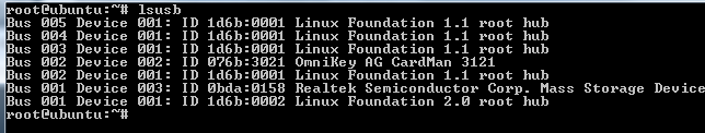

I think i already answered this edit your reader
Code:
protocol = pcsc
device = 00 could also be 1,2 or 3 depending on port used. Do not go by what you see if you issue lsusb
This is a screenshot of my own & for me it is device = 0
