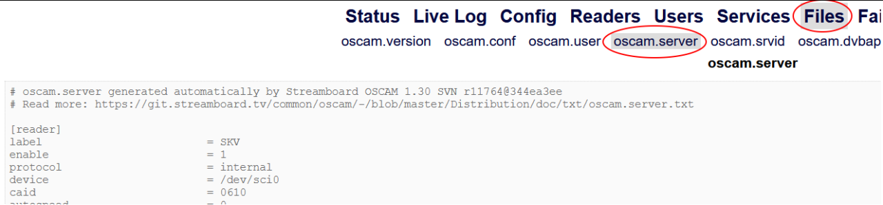

The saga continues...
Aanpassingen gedaan en zo ziet mijn oscam.server er nu uit:
[reader]
label                               = SKV
enable                           = 1
protocol                        = internal
device                            = /dev/sci0
caid                               = 0610
boxkey                          = 1122..8
rsakey                           = 3C8..A
force_irdeto                 = 1
needsglobalfirst          = 1
detect                            = cd
mhz                               = 500
cardmhz                       = 600
ident                              = 0610:000000
group                            = 1
emmcache                  = 1,3,2,0
auprovid                      = 03F9EC
De 'auprovid' heb ik nu veranderd naar de eerste waarde die ik in de log bij 'active providers' zag (is dit okee of moet ik hier een andere waarde neerzetten?)

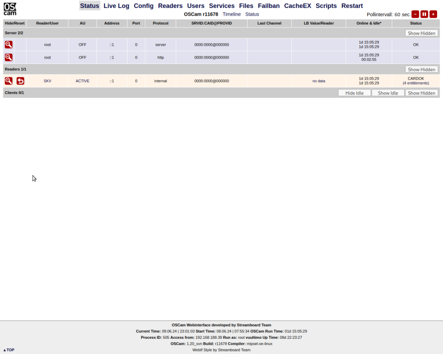

Helaas nog steeds zwart beeld als ik naar een gecodeerde zender ga. Dit zie ik dan in de log:
2024/06/03 19:40:38 494B104A c (ecm) dvbapiau (0610@000000/0000/0C1D/4A:FF1189C6E289488FB4B9A746883BCB32): not found (166 ms) by SKV (SKV dynamic RSA init or pa)
2024/06/03 19:40:39 494B104A c (ecm) dvbapiau (0610@000000/006A/0C1D/4C:392390B6C8C6679EB307D3D5D0F8B41A): not found (169 ms) by SKV (SKV unsubscribed channel o)
2024/06/03 19:40:39 494B104A c (ecm) dvbapiau (0610@000000/004B/0C1D/4C:878213516612713B5EAEAE1CE65BA959): not found (170 ms) by SKV (SKV unsubscribed channel o)
2024/06/03 19:40:40 494B104A c (dvbapi) Demuxer 1 restarting decoding requests after 0 ms with 1 enabled and 0 disabled ecmpids!
2024/06/03 19:40:40 494B104A c (dvbapi) Demuxer 1 trying to descramble PID 0 CAID 0610 PROVID 000000 ECMPID 0AC7 ANY CHID PMTPID 0C26 VPID 0C27
2024/06/03 19:40:40 494B104A c (ecm) dvbapiau (0610@000000/0000/0C1D/4A:0C56526082DDB7A9CE3E8B278CAF2E3A): not found (168 ms) by SKV (SKV dynamic RSA init or pa)
2024/06/03 19:40:41 494B104A c (ecm) dvbapiau (0610@000000/006A/0C1D/4C:35B58B39709A802F657388269F482261): not found (170 ms) by SKV (SKV unsubscribed channel o)
2024/06/03 19:40:41 494B104A c (ecm) dvbapiau (0610@000000/004B/0C1D/4C:878213516612713B5EAEAE1CE65BA959): not found (1 ms) by SKV
2024/06/03 19:40:41 494B104A c (dvbapi) Demuxer 1 restarting decoding requests after 0 ms with 1 enabled and 0 disabled ecmpids!
2024/06/03 19:40:41 494B104A c (dvbapi) Demuxer 1 trying to descramble PID 0 CAID 0610 PROVID 000000 ECMPID 0AC7 ANY CHID PMTPID 0C26 VPID 0C27
2024/06/03 19:40:42 494B104A c (ecm) dvbapiau (0610@000000/0000/0C1D/4A:0C56526082DDB7A9CE3E8B278CAF2E3A): not found (1 ms) by SKV
2024/06/03 19:40:42 494B104A c (ecm) dvbapiau (0610@000000/006A/0C1D/4C:35B58B39709A802F657388269F482261): not found (1 ms) by SKV
2024/06/03 19:40:42 494B104A c (ecm) dvbapiau (0610@000000/004B/0C1D/4C:878213516612713B5EAEAE1CE65BA959): not found (1 ms) by SKV
2024/06/03 19:40:43 494B104A c (dvbapi) Demuxer 1 restarting decoding requests after 0 ms with 1 enabled and 0 disabled ecmpids!
2024/06/03 19:40:43 494B104A c (dvbapi) Demuxer 1 trying to descramble PID 0 CAID 0610 PROVID 000000 ECMPID 0AC7 ANY CHID PMTPID 0C26 VPID 0C27
2024/06/03 19:40:43 494B104A c (ecm) dvbapiau (0610@000000/0000/0C1D/4A:0C56526082DDB7A9CE3E8B278CAF2E3A): not found (1 ms) by SKV
2024/06/03 19:40:44 494B104A c (ecm) dvbapiau (0610@000000/006A/0C1D/4C:35B58B39709A802F657388269F482261): not found (1 ms) by SKV
2024/06/03 19:40:44 494B104A c (ecm) dvbapiau (0610@000000/004B/0C1D/4C:878213516612713B5EAEAE1CE65BA959): not found (1 ms) by SKV
2024/06/03 19:40:44 494B104A c (dvbapi) Demuxer 1 restarting decoding requests after 0 ms with 1 enabled and 0 disabled ecmpids!
2024/06/03 19:40:44 494B104A c (dvbapi) Demuxer 1 trying to descramble PID 0 CAID 0610 PROVID 000000 ECMPID 0AC7 ANY CHID PMTPID 0C26 VPID 0C27
2024/06/03 19:40:45 494B104A c (ecm) dvbapiau (0610@000000/0000/0C1D/4A:0C56526082DDB7A9CE3E8B278CAF2E3A): not found (1 ms) by SKV
2024/06/03 19:40:45 494B104A c (ecm) dvbapiau (0610@000000/006A/0C1D/4C:35B58B39709A802F657388269F482261): not found (1 ms) by SKV
2024/06/03 19:40:46 494B104A c (ecm) dvbapiau (0610@000000/004B/0C1D/4C:878213516612713B5EAEAE1CE65BA959): not found (171 ms) by SKV (SKV unsubscribed channel o)
2024/06/03 19:40:46 494B104A c (dvbapi) Demuxer 1 restarting decoding requests after 1 ms with 1 enabled and 0 disabled ecmpids!
2024/06/03 19:40:46 494B104A c (dvbapi) Demuxer 1 trying to descramble PID 0 CAID 0610 PROVID 000000 ECMPID 0AC7 ANY CHID PMTPID 0C26 VPID 0C27
Ik hoop dat dit voor de experts het probleem duidelijk maakt?

Probeer deze speciale oscam zonder 'boxkey' en 'rsakey' in oscam.server
[reader]
label                         = 0610
protocol                      = internal
device                        = /dev/sci0
autospeed                     = 0
caid                          = 0610
force_irdeto                  = 1
needsemmfirst                 = 1
detect                        = cd
mhz                           = 600
cardmhz                       = 600
ident                         = 0610:000000
group                         = 1
emmcache                      = 0,2,15,0
blockemm-unknown              = 1
OSCam-11784-801 (arm).zip
aangepast door berrysam
@LuzUo
Kan je ook je oscam.conf en oscam.user laten zien?

Ik denk dat zonder de rsakey en aeskey de kaart niet gelezen wordt, probeer maar en start de reader dan nog maar een keer op en kijk in de Live Log. Waarschijnlijk staat er dan card not supported.
Wel mhz veranderen in:    mhz = 600
needsglobalfirst          = 1         moet       needsemmfirst            = 1            zijn denk ik ook.

als ik 'needsglobalfirst' verander in 'needsemmfirst' dan werkt het nog steeds niet maar zie ik in de logging
2024/06/05 08:39:10 494B104A c (dvbapi) Warning reader SKV received no emms for the last 1717569550 seconds -> skip, this reader needs emms first!
2024/06/05 08:39:10 494B104A c (dvbapi) Demuxer 0 impossible to descramble PID 0 CAID 0610 PROVID 000000 ECMPID 0577 PMTPID 12D4 (NO MATCHING READER)
Dit stond eerder niet in de logging. Ik zou zeggen dat EMM's dus ontbreken.
Mijn oscam.conf:
[global]
disablelog                       = 1
disableuserfile                = 1
usrfileflag                        = 0
maxlogsize                     = 10
preferlocalcards            = 1
saveinithistory                = 1
lb_mode                          = 0
unlock_parental             = 1
disablecrccws_only_for  = 098C:000000;09C4:000000;098D:000000
[cs378x]
port                          = 12005
[webif]
httpport                = 8081
httpallowed            = 10.0.0.0-10.255.255.255,172.16.0.0-172.31.255.255,192.168.0.0-192.168.255.255,127.0.0.1
[dvbapi]
enabled                    = 1
pmt_mode                = 6
au                             = SKV
user                          = dvbapiau
boxtype                    = dreambox
Deze oscam.conf heb ik bij mijn weten, op de 'au' na,  verder (nog) niet aangepast.
De oscam.user ziet er zo uit:
[account]
user             = dvbapiau
pwd             =
disabled         = 0
group             = 1
au             = SKV
Ook bij deze heb ik de 'au' veranderd en verder een '2nd_box' user weggehaald omdat ik maar 1 tuner heb en verder niet wil cardsharen intern.
