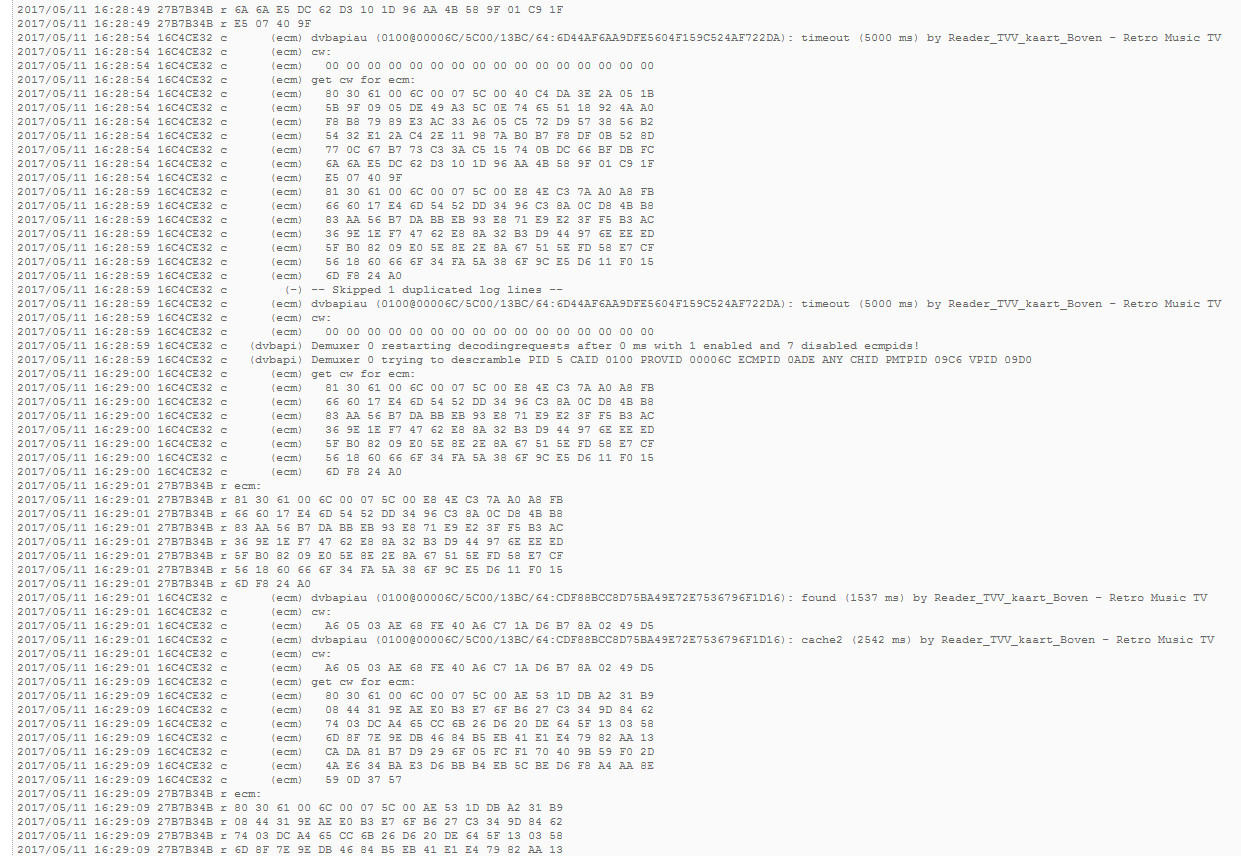

Onderaan om 17h19 is de freeze.
>> OSCam <<  cardserver log switched at Mon May  8 17:12:35 2017
2017/05/08 17:12:35 66235CB9 c      (ecm) anonymous (0100@00006C/5C00/177F/64:6DAB1007510D600377C347C5040F149E): found (331 ms) by Reader_TVV_kaart_Boven
2017/05/08 17:12:35 00000000   >> OSCam <<  cardserver log switched, version 1.20-unstable_svn, build r11342 (arm-linux-gnueabihf)
2017/05/08 17:12:45 66235CB9 c      (ecm) anonymous (0100@00006C/5C00/177F/64:49DA6E2DF84470CF8C23D555799D5CFD): found (331 ms) by Reader_TVV_kaart_Boven
2017/05/08 17:12:55 66235CB9 c      (ecm) anonymous (0100@00006C/5C00/177F/64:EF41203D5F3F8DFD9DDFA37CB4D84A61): found (331 ms) by Reader_TVV_kaart_Boven
2017/05/08 17:13:05 66235CB9 c      (ecm) anonymous (0100@00006C/5C00/177F/64:7534129F26B5C849BA334F6A3227CC61): found (336 ms) by Reader_TVV_kaart_Boven
2017/05/08 17:13:15 66235CB9 c      (ecm) anonymous (0100@00006C/5C00/177F/64:660B3DA33C257D8536980648FCEC9159): found (331 ms) by Reader_TVV_kaart_Boven
2017/05/08 17:13:25 66235CB9 c      (ecm) anonymous (0100@00006C/5C00/177F/64:D7EDA2FC9557724042D4C94D8E6D8A83): found (331 ms) by Reader_TVV_kaart_Boven
2017/05/08 17:13:35 66235CB9 c      (ecm) anonymous (0100@00006C/5C00/177F/64:EB905DBB8CAC6A5A6BC3297ABD367E3D): found (331 ms) by Reader_TVV_kaart_Boven
2017/05/08 17:13:45 66235CB9 c      (ecm) anonymous (0100@00006C/5C00/177F/64:0081032D60FEC7622D17B270DFF434C9): found (335 ms) by Reader_TVV_kaart_Boven
2017/05/08 17:13:55 66235CB9 c      (ecm) anonymous (0100@00006C/5C00/177F/64:F6FD573A4E9B413ED64247C2A7ADFA9A): found (331 ms) by Reader_TVV_kaart_Boven
2017/05/08 17:14:05 66235CB9 c      (ecm) anonymous (0100@00006C/5C00/177F/64:ED8E21CECEBEAA480C92A9DC3827D006): found (331 ms) by Reader_TVV_kaart_Boven
2017/05/08 17:14:15 66235CB9 c      (ecm) anonymous (0100@00006C/5C00/177F/64:F8B8298B6DDFA51DB4D294D196B1BFA1): found (331 ms) by Reader_TVV_kaart_Boven
2017/05/08 17:14:25 66235CB9 c      (ecm) anonymous (0100@00006C/5C00/177F/64:BC9D3693DDC994E7A4AFD24E0692526A): found (335 ms) by Reader_TVV_kaart_Boven
2017/05/08 17:14:35 66235CB9 c      (ecm) anonymous (0100@00006C/5C00/177F/64:2229AAA3D9198CB75A07000DF2A311E0): found (331 ms) by Reader_TVV_kaart_Boven
2017/05/08 17:14:45 66235CB9 c      (ecm) anonymous (0100@00006C/5C00/177F/64:1704533824DD26BBB3CE9CFA96FEC028): found (331 ms) by Reader_TVV_kaart_Boven
2017/05/08 17:14:55 66235CB9 c      (ecm) anonymous (0100@00006C/5C00/177F/64:D6ADFA4692D3E9DD44E8D4391BE2B80A): found (331 ms) by Reader_TVV_kaart_Boven
2017/05/08 17:15:05 66235CB9 c      (ecm) anonymous (0100@00006C/5C00/177F/64:234352F704C1656BE66F1B6D70940242): found (335 ms) by Reader_TVV_kaart_Boven
2017/05/08 17:15:15 66235CB9 c      (ecm) anonymous (0100@00006C/5C00/177F/64:62CF5DDCFDDF7B60A45BBB8EA35A385E): found (331 ms) by Reader_TVV_kaart_Boven
2017/05/08 17:15:25 66235CB9 c      (ecm) anonymous (0100@00006C/5C00/177F/64:0E31BE9B132714AA483883997810051B): found (331 ms) by Reader_TVV_kaart_Boven
2017/05/08 17:15:35 66235CB9 c      (ecm) anonymous (0100@00006C/5C00/177F/64:4186DCE6ACB46B8294AD3574FBC469BF): found (332 ms) by Reader_TVV_kaart_Boven
2017/05/08 17:15:45 66235CB9 c      (ecm) anonymous (0100@00006C/5C00/177F/64:213E57E7815DDA5CCB01EDF5CA8A9DFE): found (335 ms) by Reader_TVV_kaart_Boven
2017/05/08 17:15:55 66235CB9 c      (ecm) anonymous (0100@00006C/5C00/177F/64:6B470C1748D4D9A6FA3CBDD25641F334): found (331 ms) by Reader_TVV_kaart_Boven
2017/05/08 17:16:05 66235CB9 c      (ecm) anonymous (0100@00006C/5C00/177F/64:8FF4A65F8A23A4C23829FE098E28FF5A): found (331 ms) by Reader_TVV_kaart_Boven
2017/05/08 17:16:15 66235CB9 c      (ecm) anonymous (0100@00006C/5C00/177F/64:1E33FE17315197FD0EC8F5E3DE8922BD): found (331 ms) by Reader_TVV_kaart_Boven
2017/05/08 17:16:25 66235CB9 c      (ecm) anonymous (0100@00006C/5C00/177F/64:1313895EDF9B3899D6B93521D488D7C2): found (334 ms) by Reader_TVV_kaart_Boven
2017/05/08 17:16:35 66235CB9 c      (ecm) anonymous (0100@00006C/5C00/177F/64:A63DBAEE1DC56A6F945AC4CDF49D5DE4): found (329 ms) by Reader_TVV_kaart_Boven
2017/05/08 17:16:45 66235CB9 c      (ecm) anonymous (0100@00006C/5C00/177F/64:881183AD45C8C9124FD9CA8E51EA668B): found (331 ms) by Reader_TVV_kaart_Boven
2017/05/08 17:16:55 66235CB9 c      (ecm) anonymous (0100@00006C/5C00/177F/64:634A1A35D2787FC4839A5CC6DBE7F451): found (332 ms) by Reader_TVV_kaart_Boven
2017/05/08 17:17:05 66235CB9 c      (ecm) anonymous (0100@00006C/5C00/177F/64:FF658B6AB7D142D817C9A1D87FC14070): found (333 ms) by Reader_TVV_kaart_Boven
2017/05/08 17:17:15 66235CB9 c      (ecm) anonymous (0100@00006C/5C00/177F/64:6E566D0A75920FF4F3340451D0368584): found (329 ms) by Reader_TVV_kaart_Boven
2017/05/08 17:17:25 66235CB9 c      (ecm) anonymous (0100@00006C/5C00/177F/64:E2FABC087E6BCAD559FD1108BCB29060): found (330 ms) by Reader_TVV_kaart_Boven
2017/05/08 17:17:35 66235CB9 c      (ecm) anonymous (0100@00006C/5C00/177F/64:183AADE025685E0C1F7FBA124645166F): found (329 ms) by Reader_TVV_kaart_Boven
2017/05/08 17:17:45 66235CB9 c      (ecm) anonymous (0100@00006C/5C00/177F/64:6840FE1D3A8EB70FAF6684A726212FB0): found (333 ms) by Reader_TVV_kaart_Boven
2017/05/08 17:17:55 66235CB9 c      (ecm) anonymous (0100@00006C/5C00/177F/64:74F918D5845AF424457F70C41D28C570): found (329 ms) by Reader_TVV_kaart_Boven
2017/05/08 17:18:05 66235CB9 c      (ecm) anonymous (0100@00006C/5C00/177F/64:1625D476D4D438DF8F54D2065DE0493D): found (329 ms) by Reader_TVV_kaart_Boven
2017/05/08 17:18:15 66235CB9 c      (ecm) anonymous (0100@00006C/5C00/177F/64:BF6D06BB1CDAE565A9FC5F5FE634A25C): found (329 ms) by Reader_TVV_kaart_Boven
2017/05/08 17:18:25 66235CB9 c      (ecm) anonymous (0100@00006C/5C00/177F/64:9B908CBE315F7FCD33AE3EDF6F2157B3): found (333 ms) by Reader_TVV_kaart_Boven
2017/05/08 17:18:35 66235CB9 c      (ecm) anonymous (0100@00006C/5C00/177F/64:DC97E07F1AA4DCB388C9839C9246D658): found (329 ms) by Reader_TVV_kaart_Boven
2017/05/08 17:18:45 66235CB9 c      (ecm) anonymous (0100@00006C/5C00/177F/64:3D9BDE8AA6F2989CF54DF89502828774): found (329 ms) by Reader_TVV_kaart_Boven
2017/05/08 17:19:00 66235CB9 c      (ecm) anonymous (0100@00006C/5C00/177F/64:E5437B957DF9C676492E15650AAB5C42): timeout (5001 ms) by Reader_TVV_kaart_Boven
2017/05/08 17:19:05 66235CB9 c      (ecm) anonymous (0100@00006C/5C00/177F/64:E5437B957DF9C676492E15650AAB5C42): timeout (5000 ms) by Reader_TVV_kaart_Boven
2017/05/08 17:19:05 66235CB9 c   (dvbapi) Demuxer 0 restarting decodingrequests after 0 ms with 1 enabled and 4 disabled ecmpids!
2017/05/08 17:19:05 66235CB9 c   (dvbapi) Demuxer 0 trying to descramble PID 3 CAID 0100 PROVID 00006C ECMPID 071E ANY CHID PMTPID 096F VPID 0201
2017/05/08 17:19:07 66235CB9 c      (ecm) anonymous (0100@00006C/5C00/177F/64:0EE0927C5C6DCBACC36DAA0242DF9F26): found (2030 ms) by Reader_TVV_kaart_Boven

@smetje... leuk om je eigen cfg te posten maar dat lost zijn probleem niet op.
@satelliet,
Graag het volgende veranderen in je oscam.conf en oscam.user , oscam herstarten en nog een keer proberen aub.
[dvbapi]
enabled                    = 1
pmt_mode                = 0
request_mode         = 0
au                    = 1
user                    = dvbapiau
boxtype                    = dreambox
[account]
user            = dvbapiau
keepalive       = 1
au              = 1
group           = 1,2,3
verder zie ik in  je log:
dat het fout gaat bij 17:19:00, normaal komen de ecm's om de 10 seconden en hier gebeurt iets maar helaas kan ik niet zien wat.. omdat je geen debug mode 2 hebt gekozen. Want dan zie je ook de ECMs en CW's er bij staan (vraag-antwoord)   Het is sowieso geen anti-cs want dan krijg je geen timeouts maar versleutelde CW's.
Dus graag een log met ecm's en cw's er bij.
aangepast door Codx
IPTV:  KPN Glas (AoN) 1 Gbit & IPTV KPN plus+ TV box  / Android 4K IPTV box / Kodi & Plex / 100+ TB Storage
Ik heb de config en user file aangepast, maar geen verbetering.
Verder heb ik gezocht om die debug mode 2 aan te zetten, maar mijn kennis reikt dus niet zover met Oscam.
Waar plaats ik die oscam -d <2>

Satmaat, ik jou instellingen gebruikt in de oscam maar nog steeds last van freezes.
hier een stukje van het log:

 Er is geen sprake van anti-cs hier.. dus instellingen daarvoor plaatsen zijn compleet zinloos!
In de webinterface bij livelog onderaan show settings en dan 2 kiezen

@Codx hierbij de log.
  • 2017/05/11 16:36:19 27B7B34B r 67 BB 61 3C 0A 3A 56 6D 93 F9 14 EB 4E 18 D5 E4
  • 2017/05/11 16:36:19 27B7B34B r C6 D4 04 8C
  • 2017/05/11 16:36:24 16C4CE32 c (ecm) dvbapiau (0100@00006C/5C00/13BC/64:C49508527A32A972F6D99A1DCF5B95B3): timeout (5001 ms) by Reader_TVV_kaart_Boven - Retro Music TV
  • 2017/05/11 16:36:24 16C4CE32 c (ecm) cw:
  • 2017/05/11 16:36:24 16C4CE32 c (ecm) 00 00 00 00 00 00 00 00 00 00 00 00 00 00 00 00
  • 2017/05/11 16:36:24 16C4CE32 c (ecm) get cw for ecm:
  • 2017/05/11 16:36:24 16C4CE32 c (ecm) 81 30 61 00 6C 00 07 5C 00 37 52 40 DE 2D 52 D6
  • 2017/05/11 16:36:24 16C4CE32 c (ecm) 16 A8 CA 53 13 0B 77 36 BF 7F 1C 2D 3B 9C 86 7F
  • 2017/05/11 16:36:24 16C4CE32 c (ecm) 30 46 D9 AA 6A 45 A8 8F 9C 55 E1 FA 41 6A BC 06
  • 2017/05/11 16:36:24 16C4CE32 c (ecm) F9 43 D5 25 74 0C D8 CD 00 60 37 EE 6A 9B A5 A0
  • 2017/05/11 16:36:24 16C4CE32 c (ecm) 86 49 50 C1 1D 0E D7 10 8F 2B 90 AD E9 5A E8 DC
  • 2017/05/11 16:36:24 16C4CE32 c (ecm) 67 BB 61 3C 0A 3A 56 6D 93 F9 14 EB 4E 18 D5 E4
  • 2017/05/11 16:36:24 16C4CE32 c (ecm) C6 D4 04 8C

Hier zijn inderdaad wat dingen gaande.  Allereerst ik hoop dat je getest hebt zonder cooldown instellingen, anders krijgen we wellicht een verkeerd beeld.
Als ik kijk naar jou log vallen 2 dingen op:
Allereerst de cw's geven 00 00 00 00 00 00 00 00 00 00 00 00 00 00 00 00  tijdens timeout, kortom dit lijkt mij geen instelling maar eerder iets hardware matigs of een oscam bug.(?)
En verder zie ik dat ineens 2x hetzelfde antwoord wordt afgegeven, ik vraag me af waarom dvbapi 2x hetzelfde antwoord verlangd en bovendien is de tijd erg hoog.. (1540 ms) mogelijk omdat de kaart/reader laat reageert maar dan is degene uit cache nog hoger.. (2544 ms) en dat is vreemd want normaal is 1 ms meen ik.  Kortom ik zou bijna denken dat de CPU op 100% staat soms en daarom alles vertraagd en soms niet reageert.
  • 2017/05/11 16:36:31 16C4CE32 c (ecm) dvbapiau (0100@00006C/5C00/13BC/64:70B06A02147DB130A167F38FB5180AA9): found (1540 ms) by Reader_TVV_kaart_Boven - Retro Music TV
  • 2017/05/11 16:36:31 16C4CE32 c (ecm) cw:
  • 2017/05/11 16:36:31 16C4CE32 c (ecm) AF FF 63 11 1D 70 4D DA DF 26 DA DF D2 26 3D 35
  • 2017/05/11 16:36:31 16C4CE32 c (ecm) dvbapiau (0100@00006C/5C00/13BC/64:70B06A02147DB130A167F38FB5180AA9): cache2 (2544 ms) by Reader_TVV_kaart_Boven - Retro Music TV
Volgende is vraag een log van het ruwe verkeer tussen kaart en box:
debug 1 en 4 aanzetten aub.
