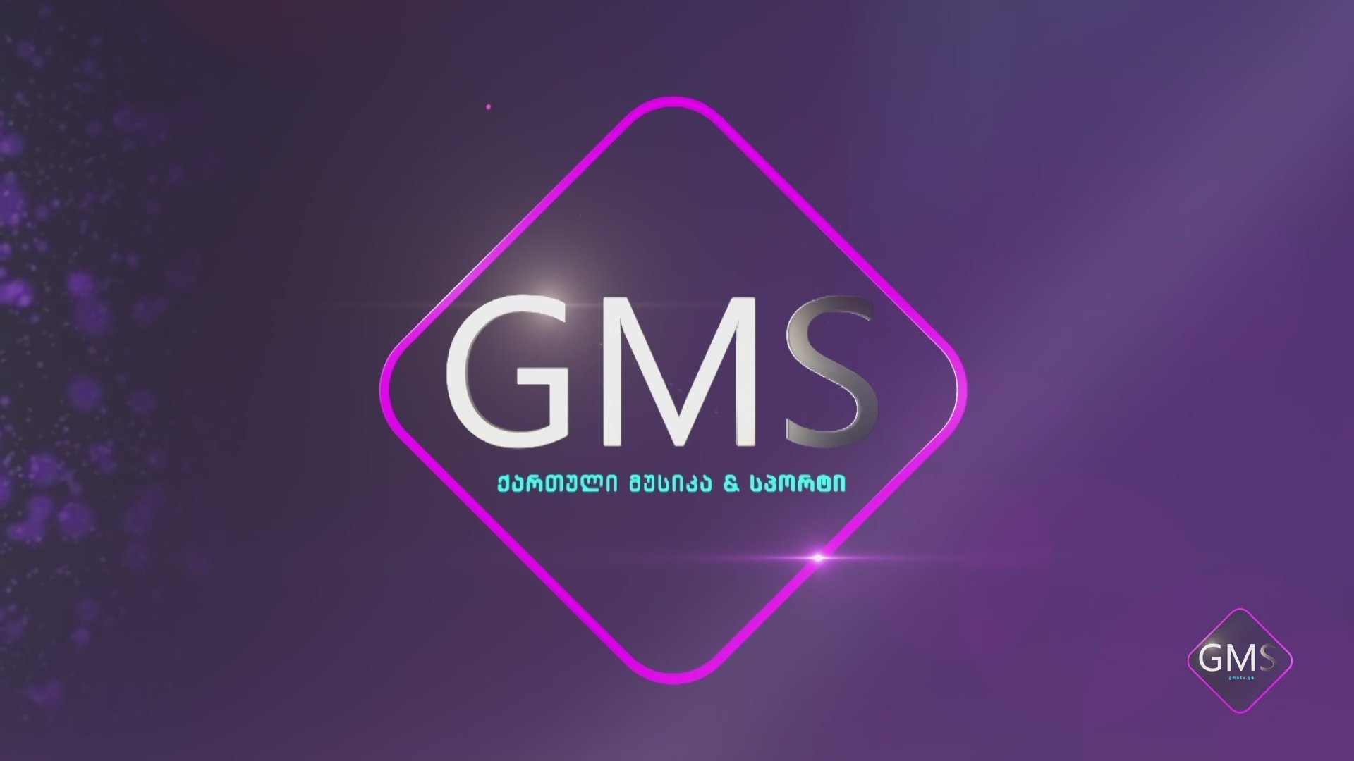

Eutelsat 36B/C - 36° Oost:
Name: "GMS TV" Provider: "Global Link"
11650, V, 10000 8PSK FEC 4/5
36.0°E (0360 - Eutelsat 36B/C)
4:2:0 1920x1080 25fps 3899kbps 16:9
NetwordID: 4 TransponderID: 11 ServiceID: 10
Video: 101(HEVC) Audio: 102 -
PCR: 101 PMT: 100 Teletext: 0
bron: https://www.medienboardonline.de

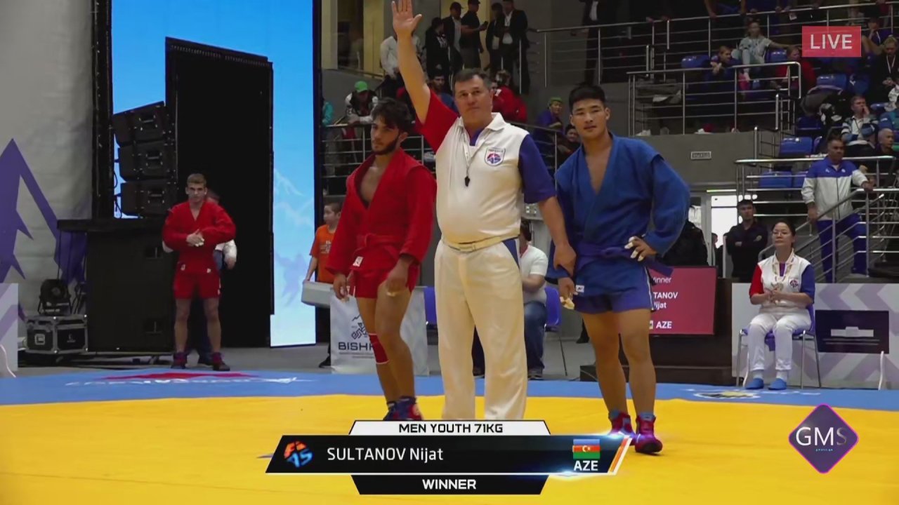

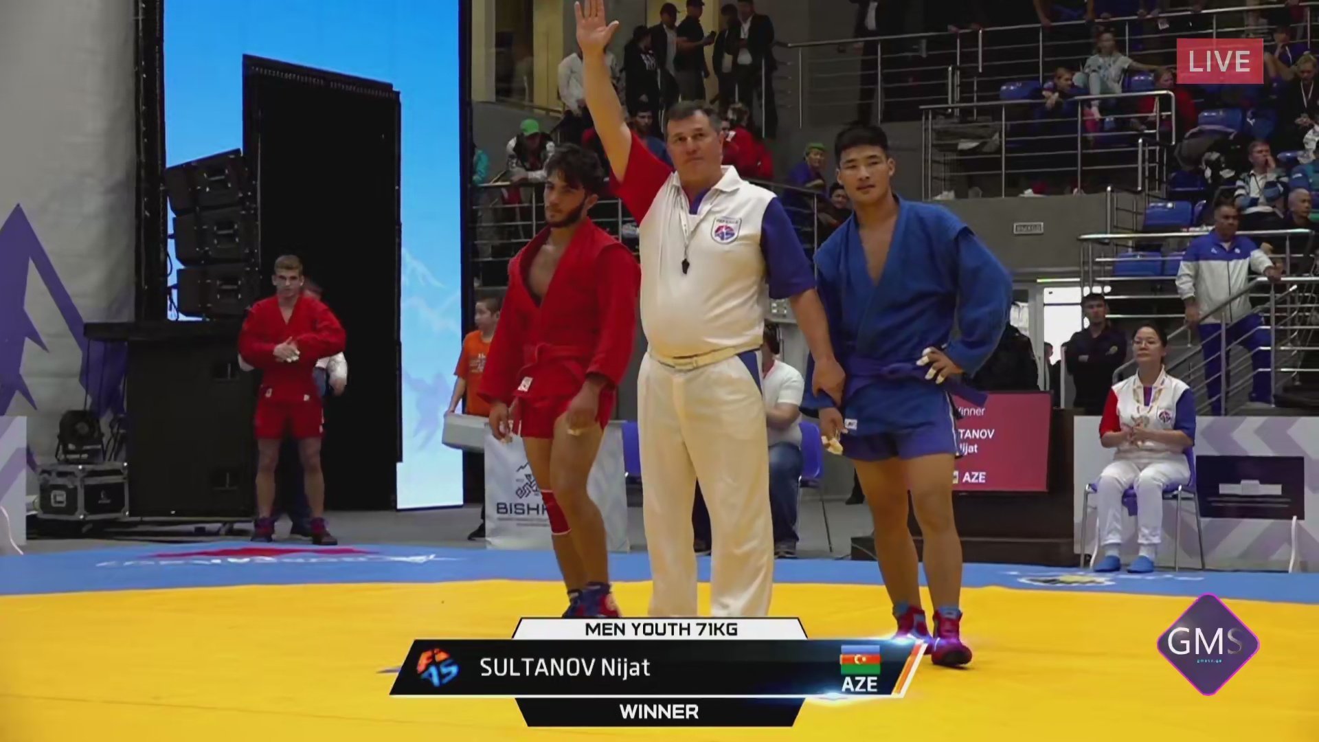

GMS TV is nu GMS Sport

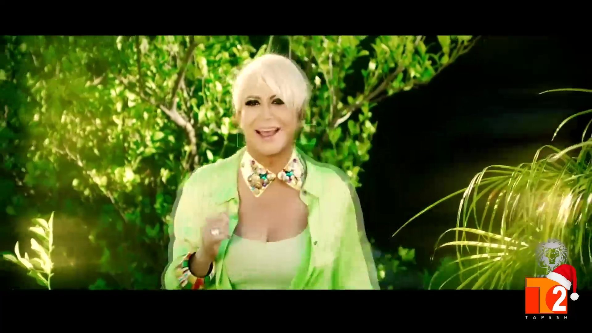

TurkmenÄlem MonacoSat - 52° Oost:
"T2" is gestopt via de 10.804 h 27.500 fec 2/3
nieuw nu in HD via de 10.762 h 30.000 fec 3/4 DVB-S2 QPSK
Name: "T2 HD" Provider: "WNS"
10762, H, 30000 NBC-QPSK FEC 3/4
52.0°E (0520 - TurkmenÄlem MonacoSat)
4:2:0 1920x1080 25fps 1829kbps 16:9
NetwordID: 4478 TransponderID: 4478 ServiceID: 27
Video: 2701(H.264) Audio: 2702 - (AAC-ADTS)
PCR: 2701 PMT: 2700 Teletext: 0

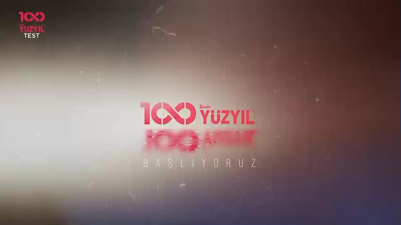

Türksat 3A/4A/5B - 42° Oost:
Name: "BIZIM YUZYIL" Provider: "TURKSAT"
11836, V, 30000 8PSK FEC 2/3
42.0°E (0420 - Türksat 3A/4A/5B)
4:2:0 1280x728 50fps 1827kbps 16:9
NetwordID: 1070 TransponderID: 43301 ServiceID: 52219
Video: 7519(H.264) Audio: 7619 -
PCR: 7519 PMT: 3519 Teletext: 0
