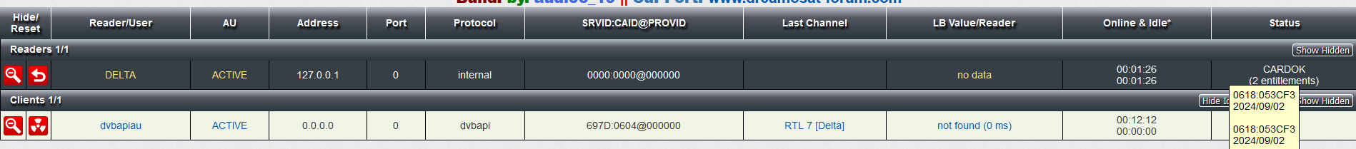

Mojo Geplaatst: 3 augustus 2024 Geplaatst: 3 augustus 2024 Ik heb nu een Delta kaart in de VU+ solo 4K maar krijg geen beeld op RTL7. Ik heb deze reader in OSCAM server en de kaart zit onderin met de chip naar beneden [reader] label = DELTA protocol = internal device = /dev/sci0 caid = 0618 boxkey = 11blabla88 rsakey = 3C8633AAC0D367blablablaA47BE1B6C76A force_irdeto = 1 detect = cd mhz = 450 cardmhz = 2700 ident = 0618:000000 group = 1 emmcache = 1,3,2,0 blockemm-unknown = 1 needsglobalfirst = 1 blockemm-g = 0 lb_weight = 500 dropbadcws = 1 auprovid = 03FB42 De kaart heeft ook al 2 entitlements Maar toch een melding "No matching Reader" 2024/08/03 16:28:05 00000000 s (main) System name = Linux 2024/08/03 16:28:05 00000000 s (main) Host name = vusolo4k 2024/08/03 16:28:05 00000000 s (main) Release = 3.14.28-1.8 2024/08/03 16:28:05 00000000 s (main) Version = #1 SMP Sun Jun 16 15:53:52 UTC 2024 2024/08/03 16:28:05 00000000 s (main) Machine = armv7l 2024/08/03 16:28:05 00000000 s (main) Stb model = dm8000 2024/08/03 16:28:05 00000000 s (main) Stb vumodel = vusolo4k 2024/08/03 16:28:05 00000000 s (main) Stb boxtype = vusolo4k 2024/08/03 16:28:05 00000000 s (main) Build = by. audi06_19 || info@dreamosat-forum.com 2024/08/03 16:28:05 00000000 s (main) SuPPort = https://www.dreamosat-forum.com/board/ 2024/08/03 16:28:05 00000000 s (main) creating pidfile /tmp/cam.pid with pid 3696 2024/08/03 16:28:05 00000000 s (relay) Stream Relay server initialized 2024/08/03 16:28:05 00000000 s (emu) OSCam-Emu version 801 2024/08/03 16:28:05 00000000 s (config) userdb reloaded: 2 accounts loaded, 0 expired, 0 disabled 2024/08/03 16:28:05 00000000 s (main) signal handling initialized 2024/08/03 16:28:05 00000000 s (config) 23 provid's loaded 2024/08/03 16:28:05 00000000 s (config) 91 service-id's loaded in 0 ms 2024/08/03 16:28:05 00000000 s (reader) DELTA [internal] creating thread for device /dev/sci0 2024/08/03 16:28:05 00000000 s (emmcache) loaded 138 emmcache records from /etc/tuxbox/config/oscam.emmcache in 2 ms 2024/08/03 16:28:05 00000000 s (emmcache) loaded 0 emmstat records from /etc/tuxbox/config/oscam.emmstat in 0 ms 2024/08/03 16:28:05 00000000 s (gbox) local gbox failed init 2024/08/03 16:28:05 04CDAA38 r (reader) DELTA [internal] Reader initialized (device=/dev/sci0, detect=cd, pll max=27.00 MHz, wanted mhz=4.50 MHz) 2024/08/03 16:28:05 04CDAA38 r (reader) DELTA [internal] Reader sci internal, detected box type: vusolo4k 2024/08/03 16:28:05 0481EA08 c (client) plain dvbapi-client granted (dvbapiau, au=auto (8 reader)) 2024/08/03 16:28:05 04CDAA38 r (reader) DELTA [internal] card detected 2024/08/03 16:28:05 00000000 (relay) WARNING: (wrong) dynamic dvbcsa parallel mode = 32 (relay buffer time: 0 ms)! ECM processing via Streamrelay does not work! 2024/08/03 16:28:05 0481EA08 c (dvbapi) dvbapi channelcache loaded from /etc/tuxbox/config/oscam.ccache 2024/08/03 16:28:05 222E545E h (webif) webif: decompressed 191091 bytes back into 494896 bytes 2024/08/03 16:28:05 222E545E h (webif) HTTP Server running. ip=0.0.0.0 port=83 2024/08/03 16:28:05 0481EA08 c (dvbapi) Detected /dev/dvb/adapter0/demux0 Api: 0, userconfig boxtype: 0 maximum number of filters is 64 (oscam limit is 64) 2024/08/03 16:28:05 0481EA08 c (dvbapi) Detected /dev/dvb/adapter0/ca0 device, total available descramblers: 16 2024/08/03 16:28:05 0481EA08 c (dvbapi) PMT mode 6: Connecting to enigma CA PMT listen socket... 2024/08/03 16:28:05 0481EA08 c (dvbapi) PMT mode 6: Successfully connected to CA PMT server (fd 10) 2024/08/03 16:28:05 0481EA08 c (dvbapi) Demuxer 0 ecmpid 0 CAID: 0604 ECM_PID: 0034 PROVID: 000000 2024/08/03 16:28:05 0481EA08 c (dvbapi) Demuxer 0 ecmpid 1 CAID: 0618 ECM_PID: 0065 PROVID: 000000 2024/08/03 16:28:05 0481EA08 c (dvbapi) Demuxer 0 found 2 ECM pids and 6 STREAM pids in CA PMT 2024/08/03 16:28:05 0481EA08 c (dvbapi) Demuxer 0 no suitable readers found that can be used for decoding! 2024/08/03 16:28:06 04CDAA38 r (reader) DELTA [internal] ATR: 3B 9F 21 0E 49 52 44 45 54 4F 20 41 43 53 20 56 37 2E 30 9F 2024/08/03 16:28:09 0481EA08 c (dvbapi) Demuxer 0 no enabled matching ecmpids -> decoding is waiting for matching readers! 2024/08/03 16:28:11 04CDAA38 r (reader) DELTA [internal] detect irdeto card 2024/08/03 16:28:11 04CDAA38 r (reader) DELTA [internal] Irdeto SC 70 version 2 revision 0, patch level 1 2024/08/03 16:28:11 04CDAA38 r (reader) DELTA [internal] caid: 0618, acs: 0.06, country code: NLD 2024/08/03 16:28:11 04CDAA38 r (reader) DELTA [internal] providers: 4, ascii serial: ##########, hex serial: ######, hex base: ## 2024/08/03 16:28:14 04CDAA38 r (reader) DELTA [internal] WARNING: For Irdeto cards you will have to set 'mhz= 600' in oscam.server 2024/08/03 16:28:14 0481EA08 c (dvbapi) Demuxer 0 no enabled matching ecmpids -> decoding is waiting for matching readers! 2024/08/03 16:28:14 04CDAA38 r (reader) DELTA [internal] active providers: 4 (053cf3,ffffff,ffffff,ffffff) 2024/08/03 16:28:14 04CDAA38 r (reader) DELTA [internal] found card system irdeto 2024/08/03 16:28:14 04CDAA38 r (reader) DELTA [irdeto] THIS WAS A SUCCESSFUL START ATTEMPT No 1 out of max allotted of 1 2024/08/03 16:28:14 04CDAA38 r (reader) DELTA [irdeto] entitlements for provider: 1, id: 053CF3 2024/08/03 16:28:14 04CDAA38 r (reader) DELTA [irdeto] chid: 006E, date: 2024/08/02 - 2024/09/02 2024/08/03 16:28:14 04CDAA38 r (reader) DELTA [irdeto] chid: 0066, date: 2024/08/02 - 2024/09/02 2024/08/03 16:28:19 0481EA08 c (dvbapi) Demuxer 0 no enabled matching ecmpids -> decoding is waiting for matching readers! 2024/08/03 16:28:21 04CDAA38 r (reader) DELTA [irdeto] ready for requests 2024/08/03 16:28:21 0481EA08 c (dvbapi) Demuxer 0 restarting decoding requests after 16540 ms with 1 enabled and 1 disabled ecmpids! 2024/08/03 16:28:21 0481EA08 c (dvbapi) Demuxer 0 trying to descramble PID 0 CAID 0604 PROVID 000000 ECMPID 0034 ANY CHID PMTPID 0A91 VPID 0ABF 2024/08/03 16:28:22 0481EA08 c (ecm) dvbapiau (P: 0604:000000:697D:0034:0064: #ECM_L:44 #CW=00000000000000000000000000000000 HOP:00): rejected group (0 ms) - RTL 7 (no matching reader) 2024/08/03 16:28:22 0481EA08 c (ecm) dvbapiau (P: 0604:000000:697D:0034:0064: #ECM_L:44 #CW=00000000000000000000000000000000 HOP:00): rejected group (1 ms) - RTL 7 (no matching reader) 2024/08/03 16:28:22 0481EA08 c (ecm) dvbapiau (P: 0604:000000:697D:0034:006E: #ECM_L:44 #CW=00000000000000000000000000000000 HOP:00): rejected group (0 ms) - RTL 7 (no matching reader) 2024/08/03 16:28:22 04CDAA38 r (reader) DELTA [irdeto] dvbapiau emmtype=global, len=37 (hex: 0x25), cnt=0: written (115 ms) 2024/08/03 16:28:23 0481EA08 c (ecm) dvbapiau (P: 0604:000000:697D:0034:006E: #ECM_L:44 #CW=00000000000000000000000000000000 HOP:00): rejected group (1 ms) - RTL 7 (no matching reader) 2024/08/03 16:28:23 0481EA08 c (ecm) dvbapiau (P: 0604:000000:697D:0034:000F: #ECM_L:44 #CW=00000000000000000000000000000000 HOP:00): rejected group (0 ms) - RTL 7 (no matching reader) 2024/08/03 16:28:23 0481EA08 c (ecm) dvbapiau (P: 0604:000000:697D:0034:000F: #ECM_L:44 #CW=00000000000000000000000000000000 HOP:00): rejected group (1 ms) - RTL 7 (no matching reader) 2024/08/03 16:28:23 0481EA08 c (dvbapi) Demuxer 0 restarting decoding requests after 1 ms with 1 enabled and 1 disabled ecmpids! 2024/08/03 16:28:23 0481EA08 c (dvbapi) Demuxer 0 trying to descramble PID 0 CAID 0604 PROVID 000000 ECMPID 0034 ANY CHID PMTPID 0A91 VPID 0ABF 2024/08/03 16:28:24 0481EA08 c (ecm) dvbapiau (P: 0604:000000:697D:0034:0064: #ECM_L:44 #CW=00000000000000000000000000000000 HOP:00): rejected group (1 ms) - RTL 7 (no matching reader) 2024/08/03 16:28:24 04CDAA38 r (reader) DELTA [irdeto] dvbapiau emmtype=shared, len=60 (hex: 0x3C), cnt=0: written (154 ms) 2024/08/03 16:28:24 0481EA08 c (ecm) dvbapiau (P: 0604:000000:697D:0034:0064: #ECM_L:44 #CW=00000000000000000000000000000000 HOP:00): rejected group (0 ms) - RTL 7 (no matching reader) 2024/08/03 16:28:24 0481EA08 c (ecm) dvbapiau (P: 0604:000000:697D:0034:006E: #ECM_L:44 #CW=00000000000000000000000000000000 HOP:00): rejected group (0 ms) - RTL 7 (no matching reader You know when you've been shagged. I like receivers who give me pleasure.
Mojo Geplaatst: 3 augustus 2024 Auteur Geplaatst: 3 augustus 2024 Inmiddels 4 entitlements op de kaart. You know when you've been shagged. I like receivers who give me pleasure.
adri Geplaatst: 3 augustus 2024 Geplaatst: 3 augustus 2024 Waarom probeert oscam ECM PID 0, CAID 0604 te gebruiken? Jouw kaart is CAID 0618 en zou ECM PID 1 moeten gebruiken. Blokkeer je soms CAID 0618 in oscam.dvbapi of heb je een prefer op CAID 0604?
Mojo Geplaatst: 3 augustus 2024 Auteur Geplaatst: 3 augustus 2024 1 uur terug, adri zei: Waarom probeert oscam ECM PID 0, CAID 0604 te gebruiken? Jouw kaart is CAID 0618 en zou ECM PID 1 moeten gebruiken. Blokkeer je soms CAID 0618 in oscam.dvbapi of heb je een prefer op CAID 0604? Nee, daar staat geen blokkade in. Alleen een M line voor CD en biss voor BBC You know when you've been shagged. I like receivers who give me pleasure.
Oplossing Mojo Geplaatst: 4 augustus 2024 Auteur Oplossing Geplaatst: 4 augustus 2024 (aangepast) Opgelost! Een beetje rommelen en ...... Werkende reader voor Delta TV: [reader] label = DELTA protocol = internal device = /dev/sci1 caid = 0618 boxkey = 11............88 rsakey = 3C8633........6C76A detect = cd mhz = 600 cardmhz = 2700 group = 2 emmcache = 1,3,2,0 blockemm-unknown = 1 needsglobalfirst = 1 blockemm-g = 0 lb_weight = 500 dropbadcws = 1 auprovid = 053CF3 4 augustus 2024 aangepast door Mojo 1 You know when you've been shagged. I like receivers who give me pleasure.
