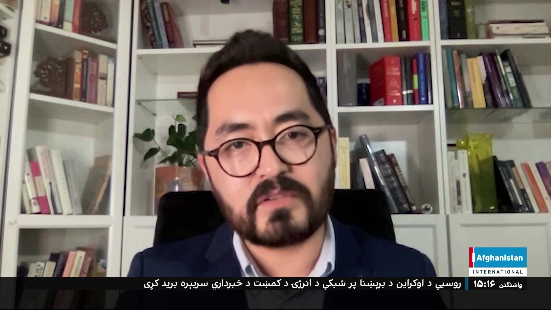

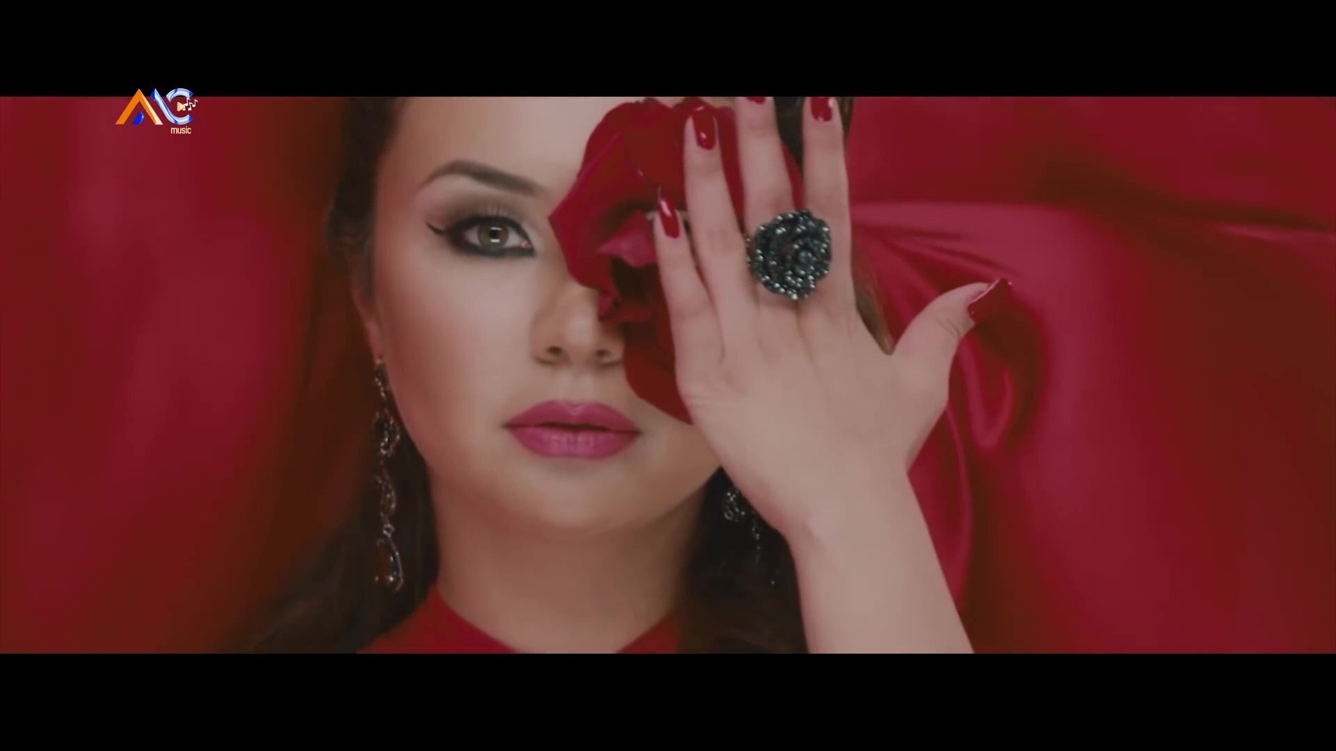

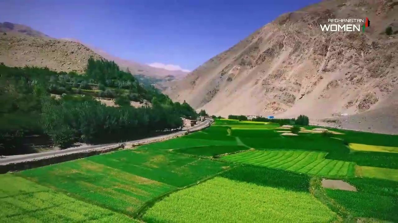

TurkmenÄlem MonacoSat - 52°E 11344 H 27500 2/3  ID's: Afghanistan Intl SD, Afghanistan Intl HD, AMC, Afghanistan Intl Radio en Afghanistan Women TV
TurkmenÄlem MonacoSat - 52°E 10887 H 30000 3/4  ID: MMA-TV
wordt gecodeerd ingelezen, maar is FTA

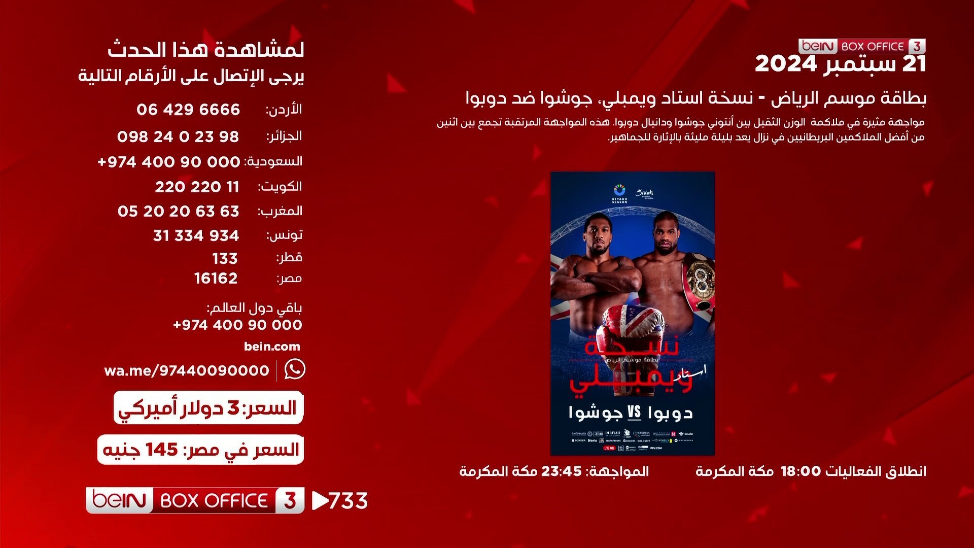

7°W 12188 H 27500 2/3  ID: beIN BOX OFFICE 3      Promo
